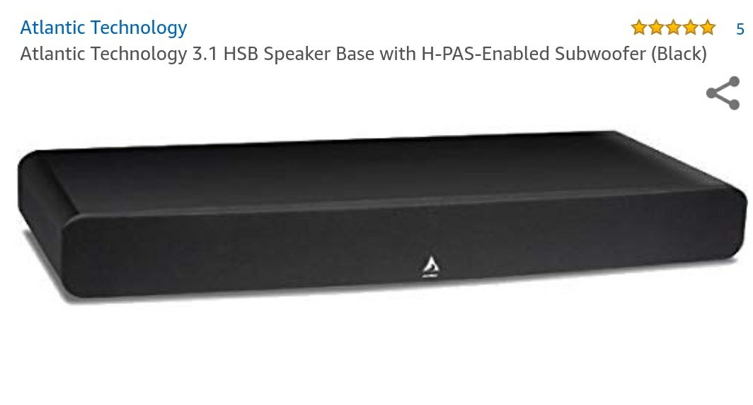

For the OP, I used the Atlantic Technology 3.1 HSB Speaker Base with H-PAS-Enabled Subwoofer (Black), which is a center, right, left speaker with powered sub in a sound bar format under TV for $799 on Amazon. I did not see many options for this and depending on what if any gear you have, I have been very happy with the 5.1 in a medium room with my ceiling surround speakers.
