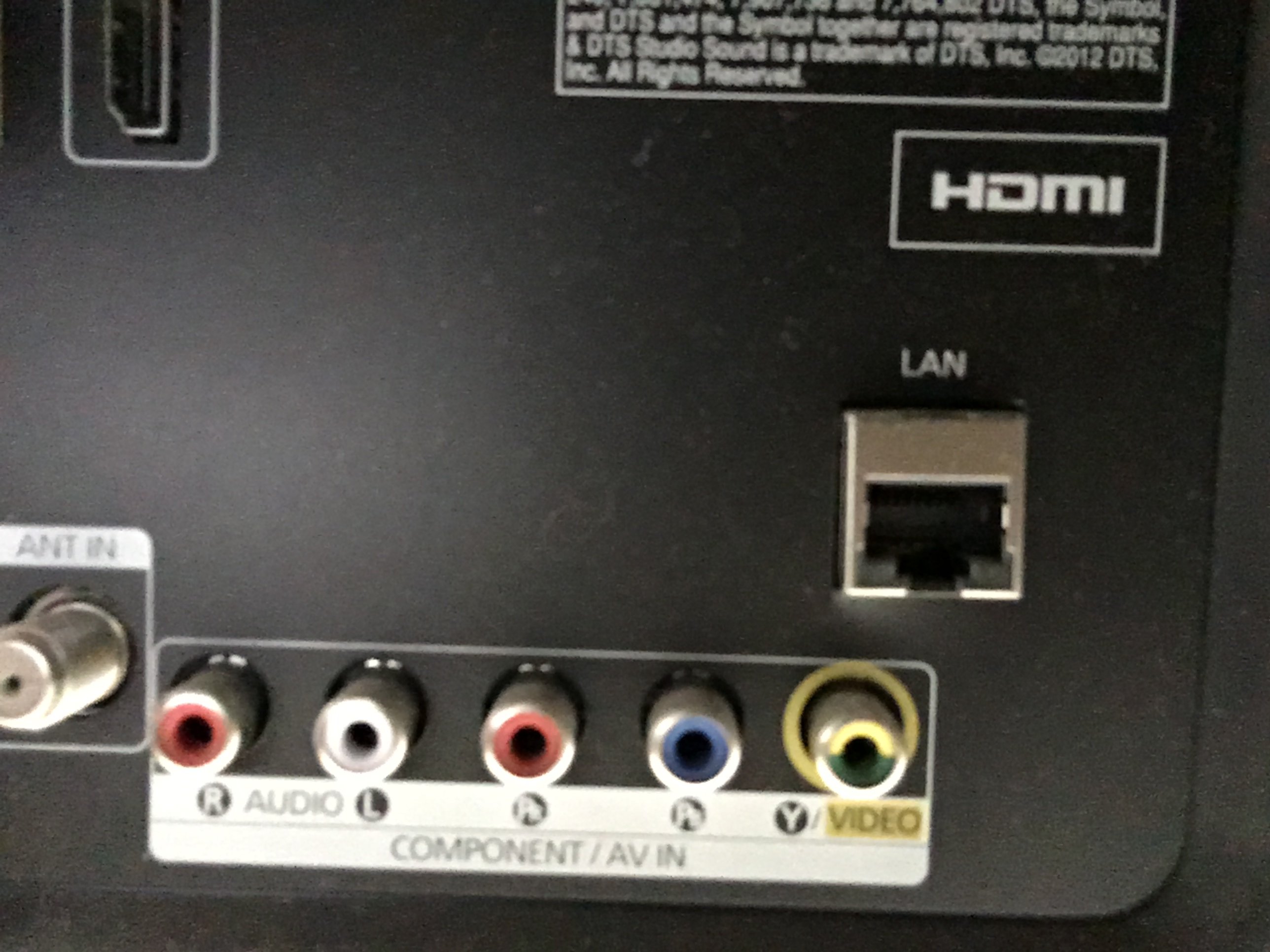

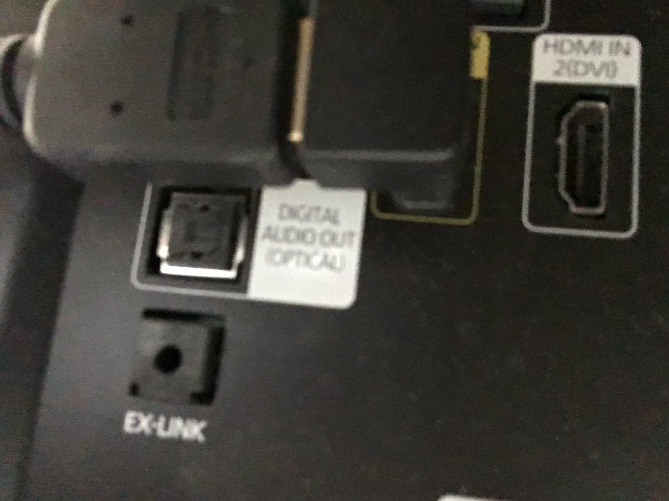

The entertainment room (see pics) contains the Bose 48 with all speakers wired to the Bose Accoustimass on the floor and then the Accoustimass is
wired to the Bose media centre in the cabinet below the rear speakers. I have included 2 pics of the rear of the TV as I assume one of these connections is the Audio return.

Your TV does not have HDMI ARC return which complicates issues. So you will have to use the optical SPDIF out connection to the receiver to hear streaming apps from your TV. This will work about as well as the 2K TVs ARC return.
The newer 4K TVs have much improved ARC return. It is much more full proof and supports loss less audio. Basically it is how this should have worked from the beginning. It is now excellent, and actually probably one of the best reasons to upgrade to a 4K TV.
