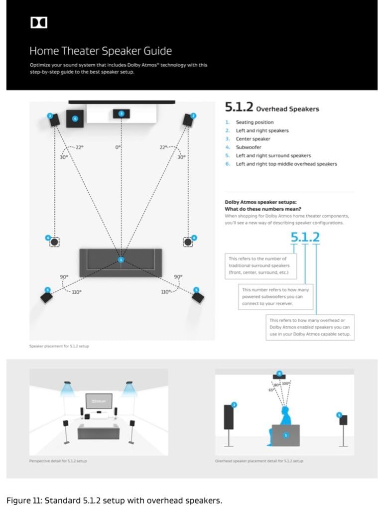

How high is the ceiling? Imo, 3’ would be too high. While it wouldn’t necessarily kill the Atmos generally speaking, it would definitely change its effectiveness. Atmos is based on angles, so it’s best to follow the guides. Problem is, there are a few of them, and some are contradictory.

Also. In the soffit are the six round holes for lights, and the rectangles for heights? I’m assuming this will have four height/top speakers? If only two, I would place the tops at about 75-80° instead of the front of the room.

I'm going to vote for regular speakers as for Dolby atmos you want the pinpoint accuracy of the sounds from all directions.
As for the height if its close to the ears distance wise you really don't want them too high like you propsed as it will sound like from above rather than beside or behind you. And you want be able to tell the difference between the overhead atmos speakers and the base layer speakers. This is of importance to getting dolby atmos as intended.
