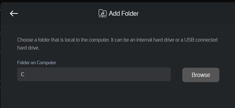

I just got a new Mesh wifi router system with three nodes. My computer with my local music files and my NAD 658 are even connected to the same node. After getting the NAD connected to the new wifi network the BluOS software refused to locate my music library that's on the same computer as the BluOS software.
When I try to add a Library, I click the Browse button and browse to the "Music" folder where all my artist subfolders are located. I click OK and all BluOS shows in the field that would show the path is C.
It's very frustrating. I can still play music via Airplay from iTunes or the BOSE wireless Link that connects to the NAD. But I'd prefer to use the BluOS software because that's where I adjust the volume and can control the base/treble. The Software can still control the NAD. It just won't recognize/connect to my local music library.
This is what I get after I've selected the music folder. Grrrrrr

Unlike when I first set it up it's telling my to type in the path in the URL format
\\Computer\share
So I typed in
\\johne\Users\johne\Music\Itunes\Itunes music\music
And it tells me to enable sharing but sharing was already enabled before I switched routers and when I click to authorize anyway it fails.

I went to file sharing and it's telling me the path is
\\JOHNE\CUsersjohneMusiciTunesiTunes MusicMusic
So I tried that and still nothing.

BluOS is based on Linux, just checked. And it's using SMB (Samba) to access Windows shares. So it seems like BluOS is expecting a network share that it can mount to its filesystem, while it seems you're specifying an absolute path to a folder it cannot process.
That's also likely why it's stripping the slashes from the name. It's common to remove what the programmer considers invalid characters from an input field as it prevents so called escape characters misuse.
It seems to me that if you set up a network share on a host with the IP 192.168.1.10 and named the share MyMusic, you should input in this field:
//192.168.1.10/MyMusic
So since this happens with your change of WiFi, a simple question is if the computer hosting your music library changed IP or it's hostname dropped or changed in the process?
To keep things simple and rule out stuff like ARC entries, I'd try with the IP of the computer (as above) rather than the name of the computer. You can find the current IP of the computer by pressing Win + R and type cmd, the ipconfig -all and somewhere in the list, you should find your ethernet interface and its IP, typically something like 192.168.1.123
Ideally the PC would be setup to use the same IP always. Dunno if yours is that, but it makes things easier if not using a professional setup where you have proper control over host and domain names.
But in any case, it seems you should not be specifying the full folder path since the share strategy appears to be for BluOS to mount a network share. It just seems odd considering their UI decision to have a "Browse" button that lets you choose other things than network shares.
When I first got the NAD and installed the BluOS Controller the Browse worked fine. What was strange is that it has a network Browse and a Local Browse. Two different places to set up the connection. I guess the Network one was for if the music library was on a different computer or the like. I set it up on the Network browse and BluOS moved it to be listed under the local Browse.
But regardless, same computer. Browse worked before but not now.

I've been working on this for 10 days. I finally got an answer back from BluOS support. It appears that somehow Windows File Explorer is giving me an alias folder name for my Music folder. The Music folder in iTunes was shared. I had to share Music2 which according to Windows File Explorer, does not exist. Why would windows create alias file folder names?
Anyway, after sharing Music2, BluOS is now able to access my music library.

When I right click on the music folder > Properties> General tab I get
C:\Users\Johne\Music\iTunes\iTunes Media\Music
When I click on the Sharing tab I get \\Crazyf*\Music2
* In place of my full name which is different from Johne
iTunes found it fine.
BluOS is now working fine looking at Music2.
If I navigate to the music folder from the OS root it's
OS (C: ) >Users>Desktop>Music>iTunes>iTunes Music>Music
It substitutes JohnE with Crazyf with Desktop all depending on how I check the folder.

I just finished doing a search for Music starting from C: with File Explorer and it found the correct Music folders in the string Music>iTunes>iTunes Music>Music
The same search came up empty on Music2. Music2 does not exist but BluOS likes it.
Windows is nuts! But at least everything is working now.
It's a crazy puzzle but all is working now.
