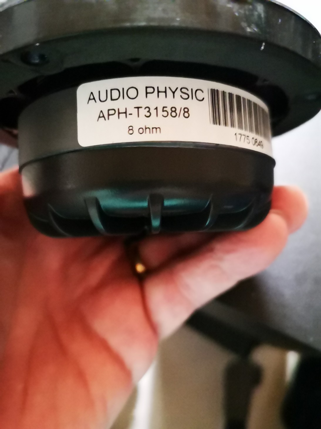

Hi every Audioholics!
I need a replacement for my tweeter but it is hard to find any information on net.
It has a label saying:
APH - T3158/8
8 Ohm
Verdinut
Verdinut
The situation is that you would need the exact same tweeter to replace it. It seems that there is none available and no other driver will do the job. In a speaker cabinet, the passive crossover is designed for the proper matching with a woofer or a mid-range driver, and this is the reason why you always need to replace with the exact same item.

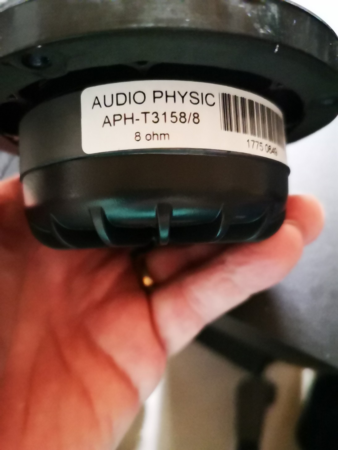

APH - T3158/8
8 OhmView attachment 69284View attachment 69285

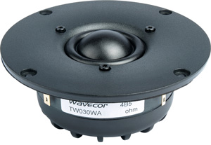

Have you contacted Audio Physic? They seem to be in business still. Where are you located? They seem to have dealers all over the world. This is the US dealer.
The drivers for Audio Physic speakers are made by Wavecore of China. They are a pretty bottom end manufacturer.
I suspect that this is basically your driver, but of course I can not be certain.
There is a very good chance this is your Tweeter available from Parts Express for $80.00
I would say the chances are high that is the tweeter you need and will be a drop in replacement.

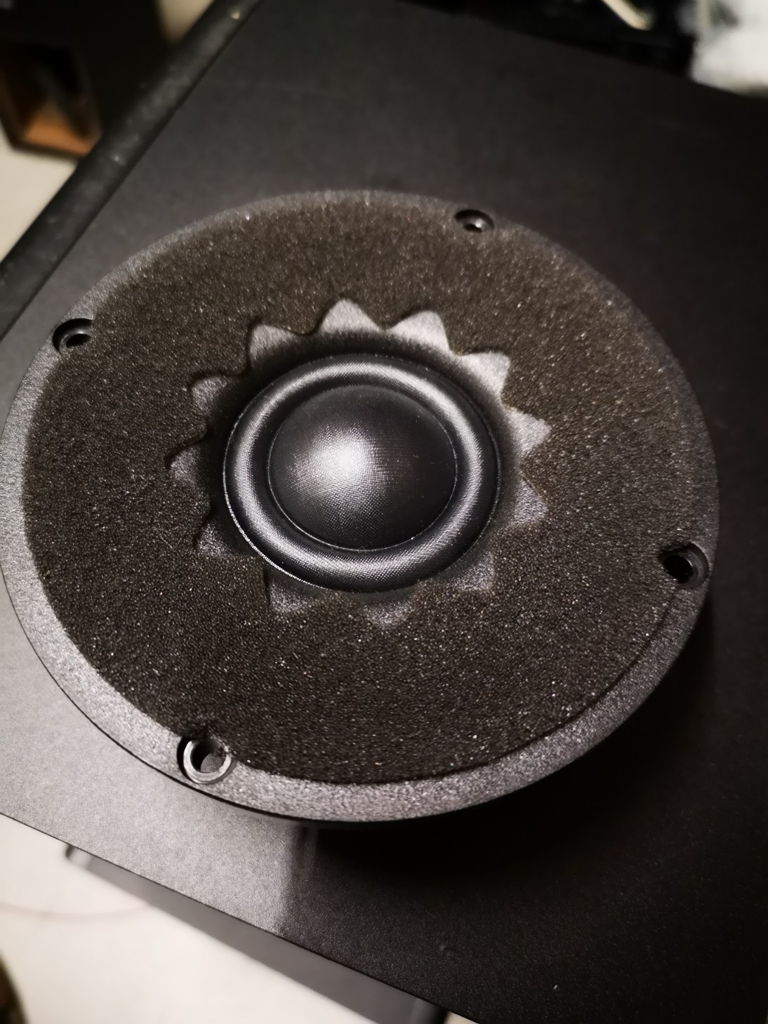

As far as I can tell all Audio Physic drivers are sourced from Wavecor.
I have at least 95% confidence I have identified your replacement tweeter.
They put an antireflective pad on the faceplate, and you can buy one here.
You got the speakers free, so for $100.00 you can most likely repair the broken speaker.
I would say $100.00 is worth the gamble.

All you have given me is one front picture and an Audio Physic number on the magnet. It does state the woofer is four ohm.
Ask the manufacturer and start there.
If they are no help, then buy a woofer tester and measure the T/S parameters of the driver and match them up with woofer T/S specs of Wavecore woofers on the Parts Express site.
