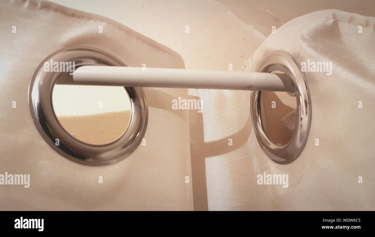

Grommets are the silver rings that the curtain rod goes through.

Yes, anchors not grommets(insert head slap)
