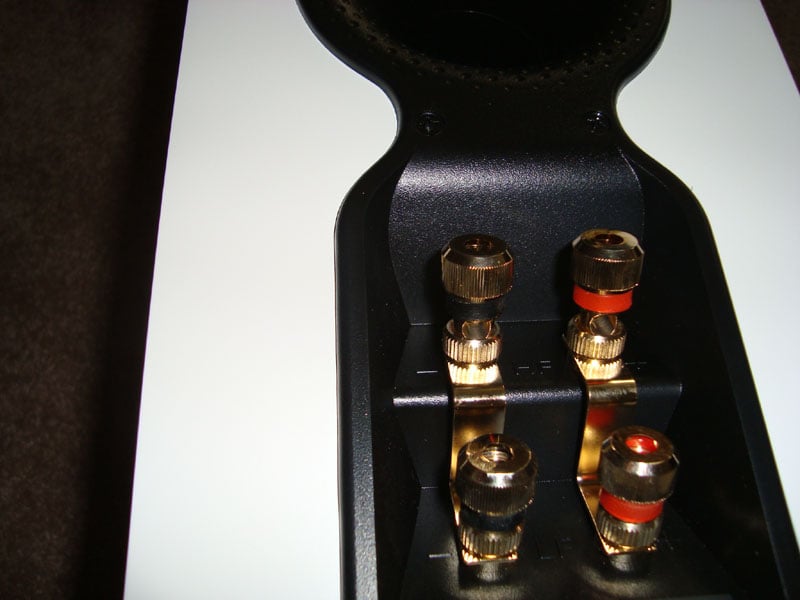

One more dummy question. On a binding post, are lower ones universally for LF and upper ones for HF? Some speakers do have this labeled with HF and LF.
This is why I'm asking. In my Denons manual there is a bi-amping scheme and upper binding posts are presented to be connected with FR/LR terminals for LF and lower to be connected with SBR/SBR For HF.
To me it's reversed logic o_O

Makes no difference since its the same signal from the avr....but position of the bi wire/biamp terminals usually goes with driver orientation....
