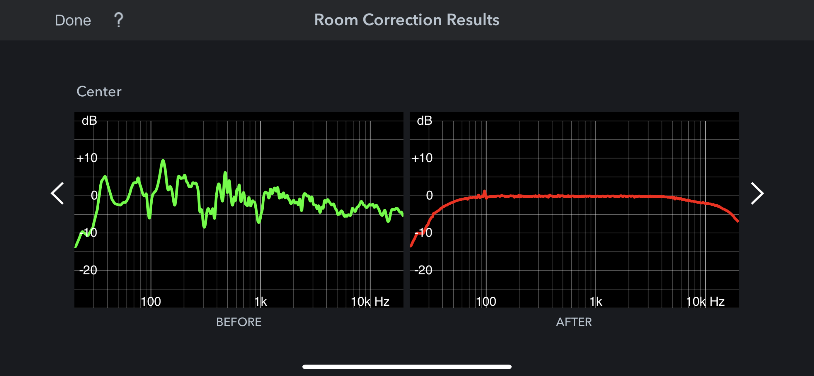

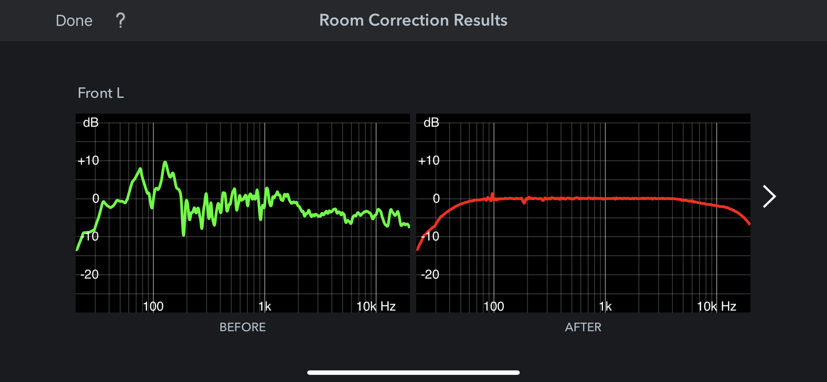

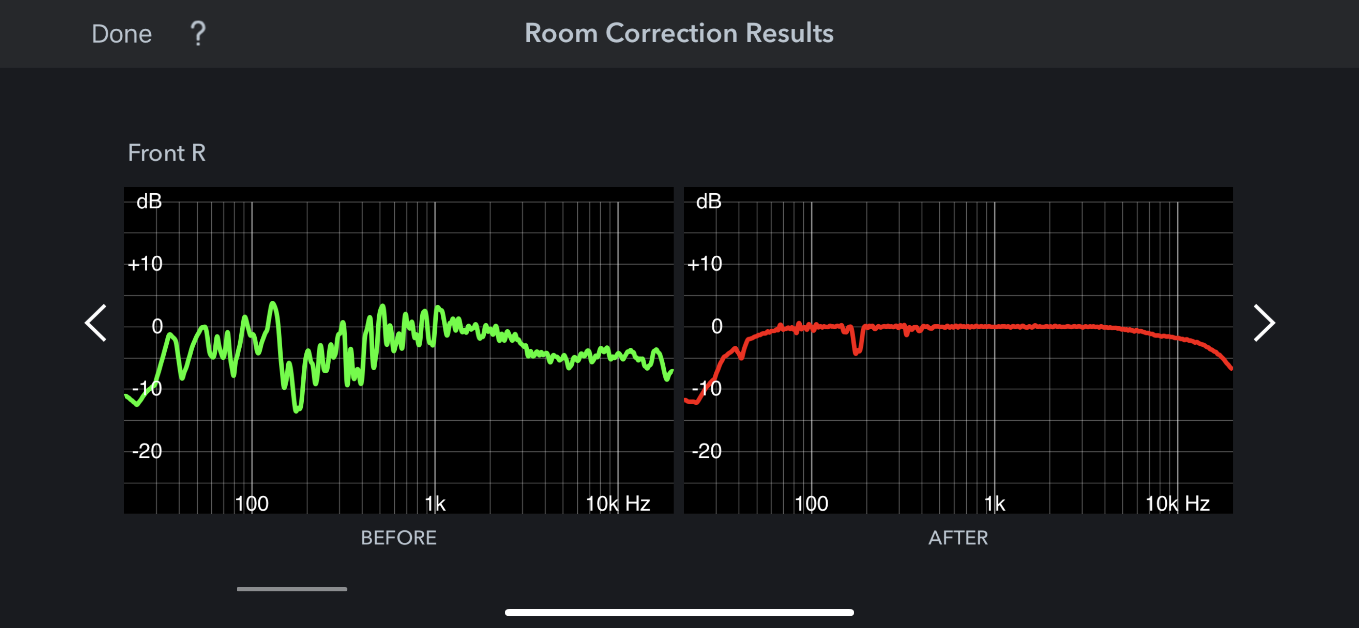

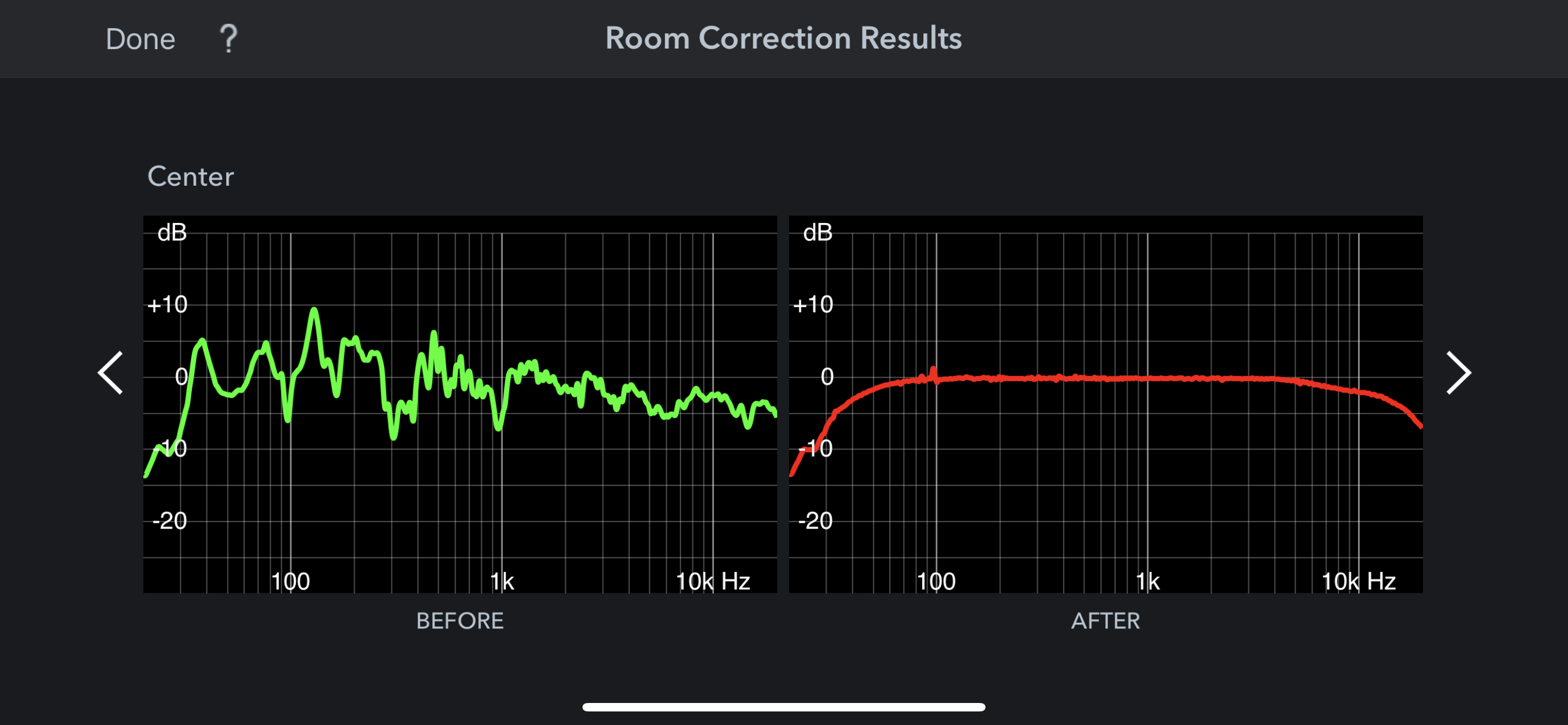

I went with the KEF q750/q650c setup. So far there is no way to classify these are bright. They are laid back compared to the SVS and the Polks I have. The sound stage is very large.
I am having issues with detail and dialogue. In looking at what Audyssey is measuring (and for what its worth this lines up with what I am hearing) The natural response of these in my room has a lot of high frequency slope. This makes them sound a bit flat or dull especially for movies. The example I really noticed it on is the Atmos demo "Shatter" which is a baseball chattering a window. The glass breaking sounds dull and not at all like glass. With Audyssey limited to 300Hz or off, this is the case. If I let Audyssey run full range those details are much better and glass sounds like glass. This also creates some brightness in the upper mid of dialogue in certain voices. Its not SSS sibilance, just a sharpness. Seeing the target rolloff curve to #2 helps a bit, but I do plan to run it again and play with some different Mic placements.
Music can be hit or miss with Audessey, as some tracks sound better with and some without.
The other issue is dialogue in general especially streaming and cable sources. They have much more noticeable what I would describe as almost a rustling of paper sound...like a compression artifact. I'd almost think there was a problem with the speaker but I don't hear it on most disc based sources. I think I noticed it a bit watching the Game of Thrones UHD discs though. Of course I know compressed sources are a problem and can't blame the speaker, it just wasnt as problematic with the Polk CS400i I was using for decades.
So I'm left wondering. Are the KEFs just a more revealing speaker? Are they just not as good as the Rt600i CS400i I had....which I am loath to believe. Is the 650c just not a well designed center? Are they really designed to be so rolled off as to lack detail or is it my room absorbing those frequencies and needing Audyssey to correct?
I've attached the graphs and while I know the corrected graph is merely a prediction, and even the measured side may not be the best accuracy, it does line up with what I am hearing. you can see the drop-off from 1khz on.
Actually it looks very good. When you measure at a distance, you will and should see a downward sloping HF response. This is because of the change of balance between direct and reflected sound. So I do not correct for this, as you would not if someone was talking in the room.
A lot of your problems I have noted here are related to center speaker placement. So a picture of your speaker layout would be very helpful. The fact you have a nice wide soundstage is very encouraging.
One of the big issues with centers is that for obvious reasons the center speakers gets placed too low. So I have my theater center above the screen.
This is my center response. The coaxial driver is very similar to yours in many respects.
This is the total system response at the main listening position. There is no Audyssey correction, and I don't use it. You will see there is a sloping HF response at this center second row seat. Voice clarity is excellent as well as very natural.
This is the layout.
The center has a sloping front panel directed at the seating area.
So from the look of what you posted, my first guess is probably interference from boundary effects near your center speaker.

That's encouraging. I still fee like without correcting for that drop-off the sound is too dull. So I am OK with letting Audyssey correct for it since it pulls out those details without making things harsh.

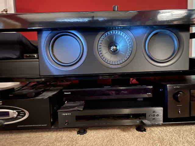

As for the center, no it is not an ideal placement. Same went for my Polk. Is on an AV shelf below the TV. There is no easy way around this. While I do expect this to cause some issues, the emphasis on that rustling sound in the dialogue seems odd. With my Cs400i, I had to get creative with Mic placement but I eventually got a calibration that made dialogue and center in general completely acceptable to me. Also feel like the q650c is drawing attention to itself more as a point source.
I'm sure you'll cringe at the placement. If I move it up, the TV sill need to be raised as well and I'm not a fan of doing that. Above pointed down isn't an option because I have a screen than comes down for my projector. The polk was probably worse off as the the tweeter was up much higher instead of being centered. The problem with the Polk was overly sibilant diaogue, which made sense since Audyssey XT "heard" an off axis response and overcompensated. XT 32 did a much better job and didn't introduce nearly as much of that.
It's odd with the Q650c. It can sound great, and then bad. Even amongst the same dialogue sequences. Some of it I have to think is due to it being a more revealing speaker and making the flaws of streamed sources more noticeable. Some of it is placement and I am going to try some of the same "tricks" I used to get the Polk sounding good.
But I also wonder, have I actually downgraded my LCRs? Is this a better speaker than the CS400i? I have a hard time believing that. But I had the dialogue pretty perfect and the mains never lacked for detail with the polk, even limited to 200hz correction.
As I suspected, your entire problem is due to placement. Unless you correct that, you will continue with unresolved problems. No amount of tinkering will make up for that, or correct it.
If you can't correct it, you may well be better off without a center. How does is sound without a center? I have a sense it will be an improvement.
I'm certain there are a lot of systems downgraded by having a center. BBC engineering thinks so as well. They refuse to include a center channel in multichannel broadcasts.
