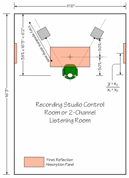

Try 38% distance from the rear wall, this should theoretically give the best bass response.
jslivingston
jslivingston
Like the guy above me stated, there's actually a lot of math involved with the different types of room modes that puts the best spot at 38% for your head.
It doesn't matter if it's front or back, the symmetrical room will act the same way, either way.
That picture shows the general idea as well as for setting up acoustic treatment on the first reflection points on the side walls and ceiling, if you're into that too.
