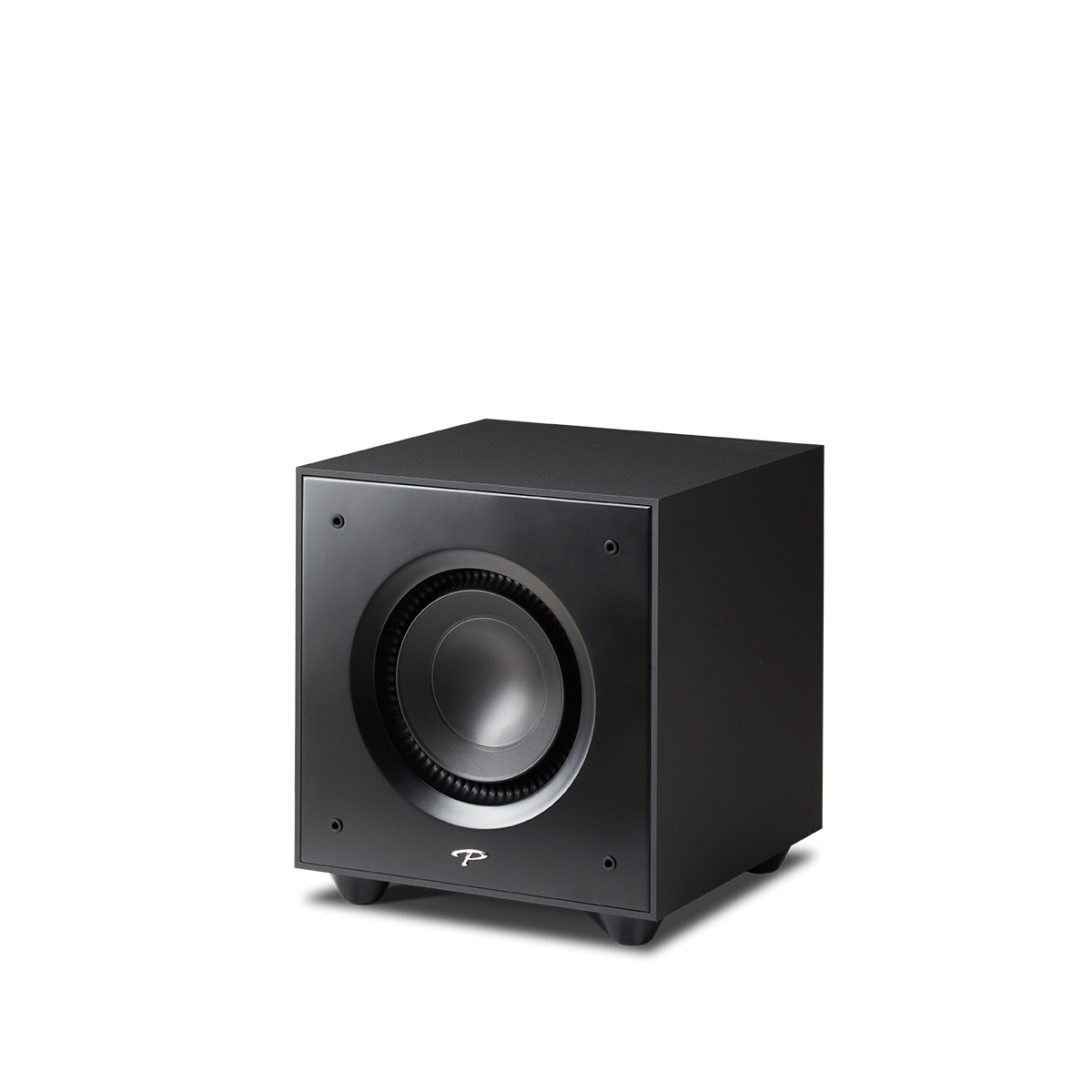

mazersteven
mazersteven
Martin Logan made the list but this didn't
stalag2005
I have the x12 and love it.
