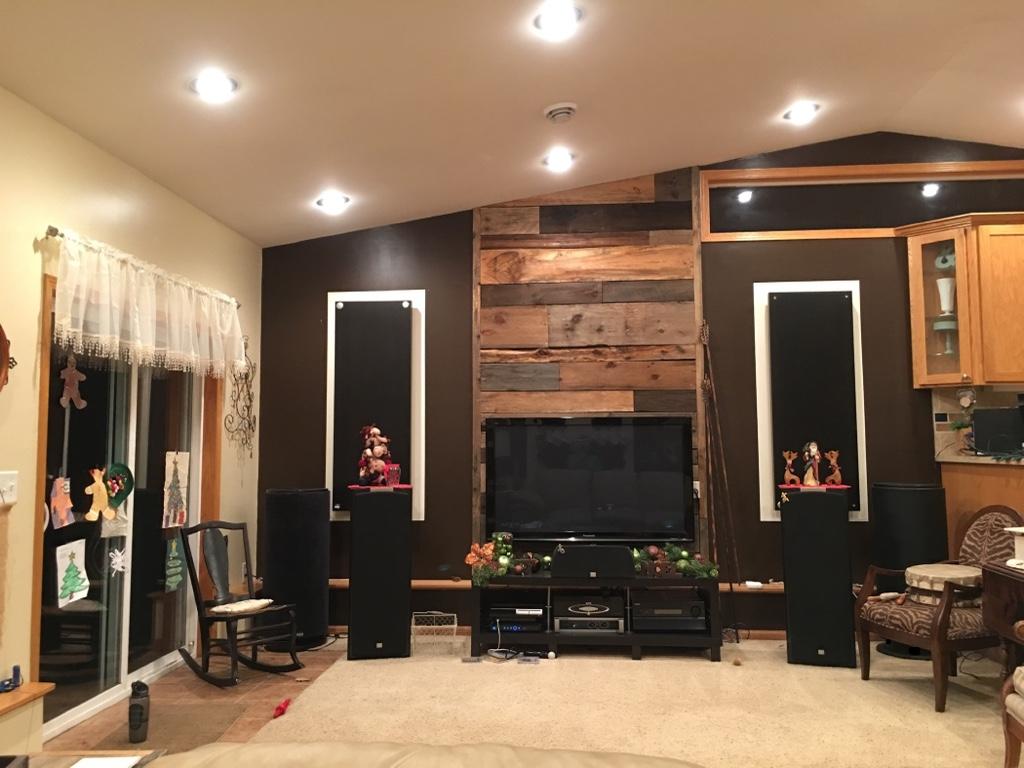

Not exactly current pic, but look. You can’t even tell there’s two pc12pluses in there. Lol. They just disappear!
