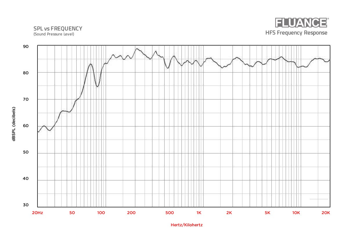

Looks like Fluance has upped their game with their Signature Series speakers ($260 / pr CAD).
I haven't heard them, but my AVBP2 bipoes sound great for what I paid for them. Both would require a sub, but at least they are reasonably neutral.
You might also check Canuck Audio Mart for some used bargains.
Well, having worked with much more expensive Fluances that posted similar frequency response plots, I would get out the salt shaker.

As in, take the measurements with a grain of salt (for unrepresented off-axis and impulse response)? Or as in, throw salt over your shoulder to ward off bad luck (for out of spec components)? Or because they're bland?
My surrounds sound pretty good firing the occasional surround effects at the back of my head. I haven't listened critically to any Fluance speakers in front of me, though.
Edit: By the way, notice that the graph of the Signature bookshelfs is on a 60dB scale. Many of their other graphs are rendered on a deceptively wider scale. The XL7F floorstanders, for example, are on a 100dB scale with the same height, thereby making the 10dB slope from 4 - 8kHz appear more subtle than it measures. The XL5F1 towers' tweeter is 10dB louder than the woofer. The SXHTBFR, 10dB quieter.
I say all that to say I'm skeptical that the much more expensive Fluances with which you worked actually produce similar frequency response plots. I wouldn't dismiss the Signature series before giving them an audition. The HFF1 floorstanders graph with a reasonably neutral response similar to the bookshelfs, as does the HFC1 center. I also observe that the Signature series is crossed over at a much more reasonable frequency (2.3kHz) than their other series speakers (6kHz in one case, 8kHz in another), so I predict mid driver breakup will be better controlled.
What am I missing?

I worked with the Signature tower speaker. I'm not sure what other speaker you have in mind. As I posted on this forum, the actual frequency response of the Signature tower looked nothing like the published version. So I think I have reason to by skeptical about the reliability of their other plots. I haven't heard the less expensive models, however, and they may be perfectly good values.

I trust your intuition over my own, so I daresay there are no miracles among the less expensive models. That's disappointing that you had that experience with the Signature towers. I thought of all their towers, the Signatures would've been the ones that would be respectable. Indeed, I was hoping the Signature center might even be a potential candidate to accompany your Affordable Accuracy monitors where a horizontal center is needed -- perhaps with some Philharmonic secret sauce applied to the crossover.
Have you considered adding a center channel to your Affordable Accuracy offerings? This MTX 6.5" MTM center might be another candidate if the Dayton center's sealed enclosure and diminutive drivers make it unsuitable. I know you traditionally recommend Salk centers for people shopping for your constructed (as opposed to modded) 2-channel offerings; but the AA market is in desperate need of a matching center.

There are long threads on this forum and AVS detailing the problems with the Signature towers. I think if you read those, you'll see that there are fundamental problems with the speaker that have forced Fluance to redesign the crossover and buy back current samples in the field (assuming the owners want to do that). I have an MTM center channel in the Affordable Accuracy line--it's a mod of the Andrew Jones Pioneer C22 center. I replace the tweeter and modify the crossover. It sells for $100.

Gene measured them. Look for a thread titled Fluance Signature.
Dennis is being nice. He reworked the crossovers for a guy and had to make two different designs for the left and right speakers because the inconsistencies in the mid-drivers were so great!

I should make clear that it is the towers Dennis worked with not the bookshelfs...but the Signature series.
