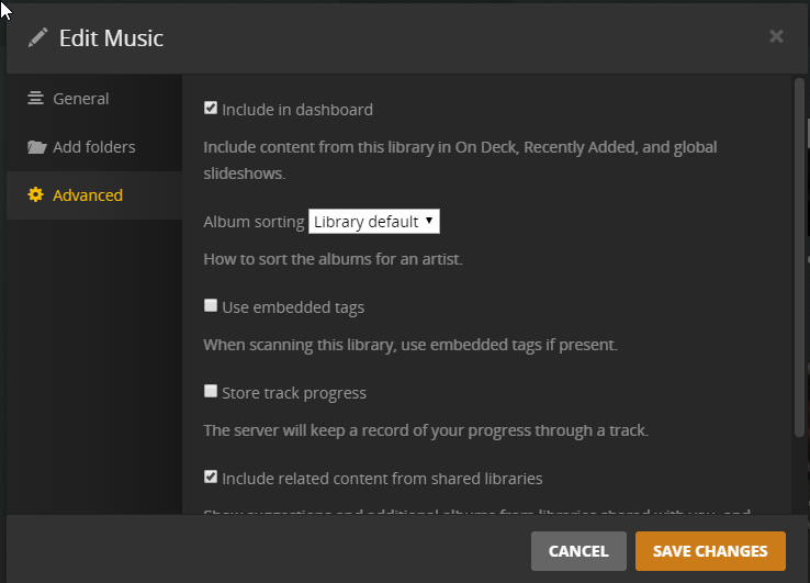

Have you checked the embedded tag option in Plex?
It took me a few moments to find that selection: I wasn't using it ! I checked it and will go and try something now that selection is made. This may help . This is the first ray of hope in several days. Let's hope it works or does something positive.
I had such high hopes for that little option of including imbedded tags. Alas, it is of no affect.
