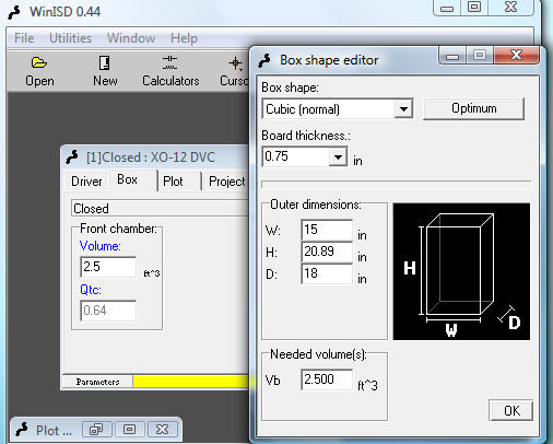

I will model those two drivers tonight. I will post the pdfs.
TLS Guy, another alternate is the XO-12 DVC from Torrent Audio at $99. Could you model that one as well please? It seems to model closely to the Shiva-12.
It may do what he wants and ease his budget constraints.

Remember 1728 cubic inches to a cubic foot. So if you had a brace of 24 inches by 24 inches by .75 inches and you cut out a section leaving 1.5 inches all around you would need to figure out that volume and increase slight the size of the box to keep your displacement.
So 24 X 1.5 X .75 X 4 X number of braces would give you the total volume you need to account for.
Assume a 2Cu Ft box sealed: Internal dimensions are 24X24X24.
So each brace is taking up around 27 inches cubed. So a box like that may only need one brace. 27 cu inches isn't much in a sealed enclosure so you most likely wouldn't bother with it.
Alternately, you could just calculate a box that is 2cu ft + the amount of bracing you are going to add and be done with it dimension wise and simply add your bracing.
Example is a 2.5 Cu Ft Box. Simply build it, throw in 2 window braces (more than enough) and don't worry yourself with the exact displacement.
