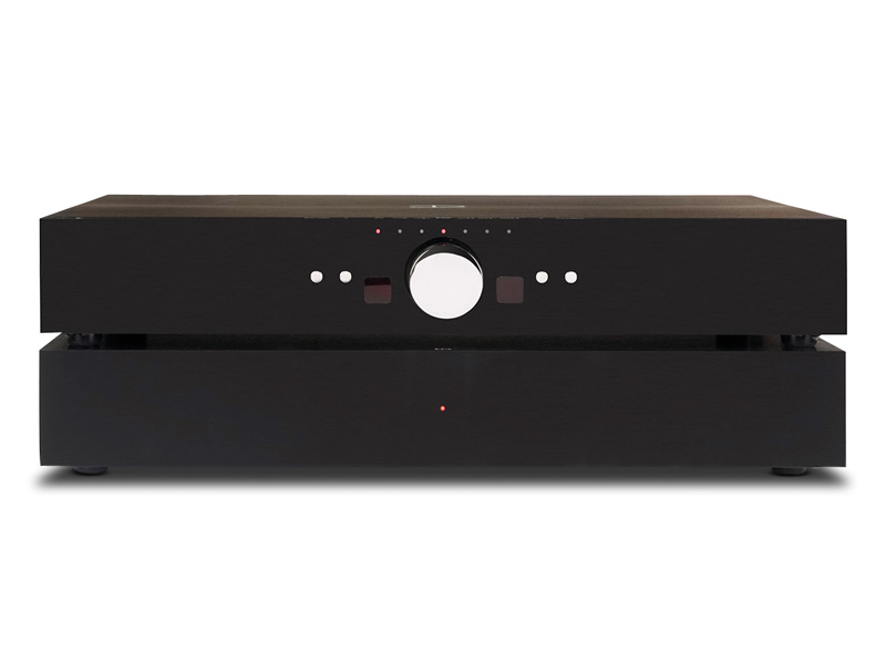

I recently added in my old Densen B300 2 channel power amplifier to drive the front left and right and the difference for both movies and music was substantial. The Densen is a Class A/B 100 Watt amplifier into 8 ohms and used to drive my KEF LS50's and RDM 2's.

Hadn't heard of Densen and just took a look at their site, nice looking boxes, some of their descriptions are a bit flowery, altho the amps appear to have decent spec. How did you integrate the amp with the avr's amps, tho?
