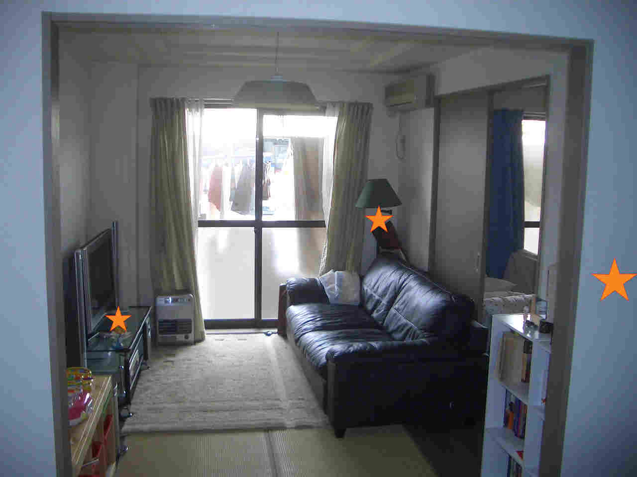

samhfoley
room picture?
CAn I upload a photo of the room to the forum? If so I'll do so when I get home. Let me know.
samhfoley
The room layout and my ideas
Here is my living room, shot from the kitchen. You can see the open wall facing the kitchen as well as the sliding door behind the sofa. The bookcases I am going to use are on the right side of the image just inside the door frame. I placed stars on where I was thinking of placing the center channel speaker and the rear surrounds (if I get any) The TV would be moved a bit to the left and 1 book case would be placed on either side of it. Still not sure where I'd park the sub yet...perhaps in the far corner under the rear surround. Anyways, that's the room, sorry for the poor quality shot, but 100KB is a pretty small file size!
F
FirstReflection
AV Rant Co-Host
Great that you uploaded that photo!
Your room is much as I pictured it from your previous description. As I suspected, you have a very close seating distance and you are basically surrounded by normal, flat walls. All of the important characteristics of which I have already spoken very much apply IMO.
I keep feeling almost apologetic for my steadfast recommendation of the EMP HTP-551 package. I've wracked my brain trying to come up with some other better alternative, but I simply cannot think of one. The exact characteristics of the EF50 and EF50C speakers are basically tailor made for your type of small room setup.
To be blunt, seeing the photo of your room only adds more reasons for me to continue to strongly favor the EMP HTP-551 speakers. For one, it would be best if you could place the centre speaker on the same shelf as the TV itself. That means that it cannot be too deep and it must also be short so that it does not obscure any of the bottom of your TV's screen. The EF50C is 6.5" deep and 5" tall which is about as small as you can make a speaker before you go into "micro" speaker territory where the midrange drivers are so small that the cross-over rises to about 180Hz and really makes getting a blend with the subwoofer difficult!
And yet another advantage of the EF50 speakers is that they are a sealed design with no ports on the back. That's going to make them more suitable for being wall mounted as surround speakers and will also help their sound if you decide to put the front Left/Right speakers inside of the bookcases rather than on the very top of them.
To be perfectly clear, your room is not ideal. Compromises have to be made and it isn't reasonable to expect "highest of the high end" sound quality when recognizing your room restrictions. Many people subscribe to the idea of buying the most technically "correct" speakers - regardless of the room - and then basically either attempting to "fix" the room and setup or else just saying, "well...it's not the speakers' fault, so end result performance be damned!"
I do not subscribe to that attitude. I see the room and the speakers as being equal partners and to me, it makes sense to recognize what the room and placement are going to do to the sound and then picking speakers that will work in harmony with those restrictions to give you an end result that is more than the sum of its parts.
For your room and setup, most speakers are simply physically too large. The centre speaker in particular needs to be able to fit on your TV stand and not block the bottom of the image nor hang way out over the edge due to being too deep! The surround speakers are best wall mounted (they should be mounted to the wall about 2-3 feet above your seated height) and with such close proximity to the wall, it would be best to use a sealed speaker design. Because you are sitting so close to the front speakers, they need to have very wide dispersion so that they can create a seemless front soundstage. And because your room is 3 flat reflective walls, it will help if the speakers have a slight high frequency roll-off so that they do not sound harsh or fatiguing. Finally, any such speakers will need the help of a subwoofer. That subwoofer needs to be an appropriate size for your room and it needs to be able to blend well with the 5 speakers.
Those are the conditions regardless of what speakers your buy. But it just so happens that the EMP HTP-551 package precisely matches all of your needs!
Almost all of the other speakers that have been recommended are larger than you may think. A 7" height is about the smallest of the other contenders and that is almost certain to block a tiny bit of the bottom of your TV screen. Several of them are ported - which typically means they need about a 2 foot distance from the wall to sound their best.
I would recommend the Emotiva ERM-1 speakers to you, but they are too large. I might also recommend the Energy RC-Mini and RC-Mini-Centre speakers, but they are ported.
I guess the simplest way I can put it is that if it were my money and I were in your room, these EMP HTP-551 speakers are what I would buy and I would certainly buy an Auralex SubDude while I was at it :)
