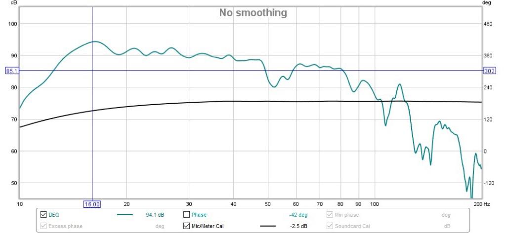

Make sure the spl meter in rew is set to C-weight, slow response. It won’t stop moving, so you might want to watch it for 10-20 seconds and mentally average the measurement and adjust as needed. Once you move the level up/down observe it again to make sure it’s in the range you want. Turn off one sub, then set the the level for the active one , then turn off/on opposite subs and set the level again. Then turn them both on and set the level where you want. There’s not an exact number, but I usually like 73db individually for duals as this usually gets to 75db combined. Then go to the measurement tab, and click it. It should bring up some parameters. Set the top to 105 and the bottom to 45. Left side to 10hz and right side to 200hz. It will check levels and usually-25 or -20 works for me. Click measure, and you should hear a sweep tone starting really low, going up until 200hz. You should see a graph showing the response of your room. At that point you can see many things like XO range, low end extension peaks and valleys etc. That will give an idea of what to fix. And maybe how. Looks like this.
This was post EQ and house curve but you can see anyways...
