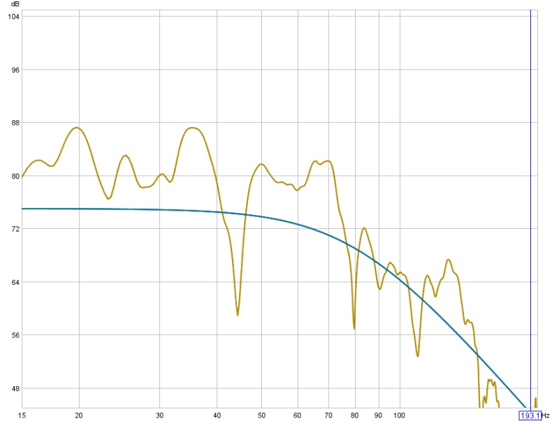

I tried the sub in the corner at the end of my room
and got a similar response to this, but it's so far away, and sounded less detailed.
Is that graph the same for its current location, in the center of that long wall?
That suck out at about 45 Hz is a big one to make up.
Have you tried to place the sub next to the couch? Perhaps just to graph it there?

The graph was taken with the sub in the location to the right of the TV in it's current location in the photo's.
