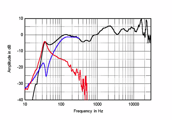

Here is Figure 3 from the review. The red trace is the response of the passive radiator and the blue trace is the bass from the 3" driver. The black trace is the overall response.
To me, the most obvious flaw I see is the elevated & ragged treble response, especially above 1,000 Hz. That 3" driver may be a good mid-range driver, but it isn't a good tweeter. That may very well be the overall brightness that you hear. I can't predict exactly how that might vary in a bi-polar design using two of those drivers, but I think the brightness will still be there.

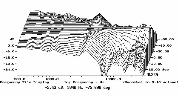

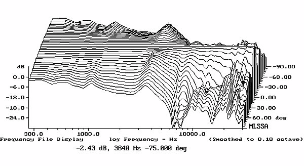

Here is Figure 4 that compares speaker output on-axis (0 degrees, see the scale on the right side) to various degrees off-axis, as high as ±90 degrees. Note how there is wide dispersion at all off-axis angles up to a peak at about 3,000 to 4,000 Hz. But higher than that, off-axis dispersion drops off considerably. No 3" driver can avoid doing that. That's what smaller tweeters are for.
