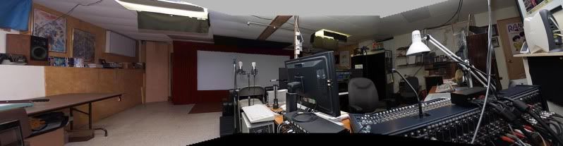

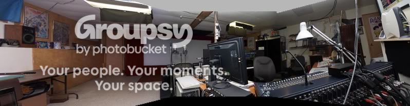

These are panoramas I made from stitched together photos. Cheap and dirty.

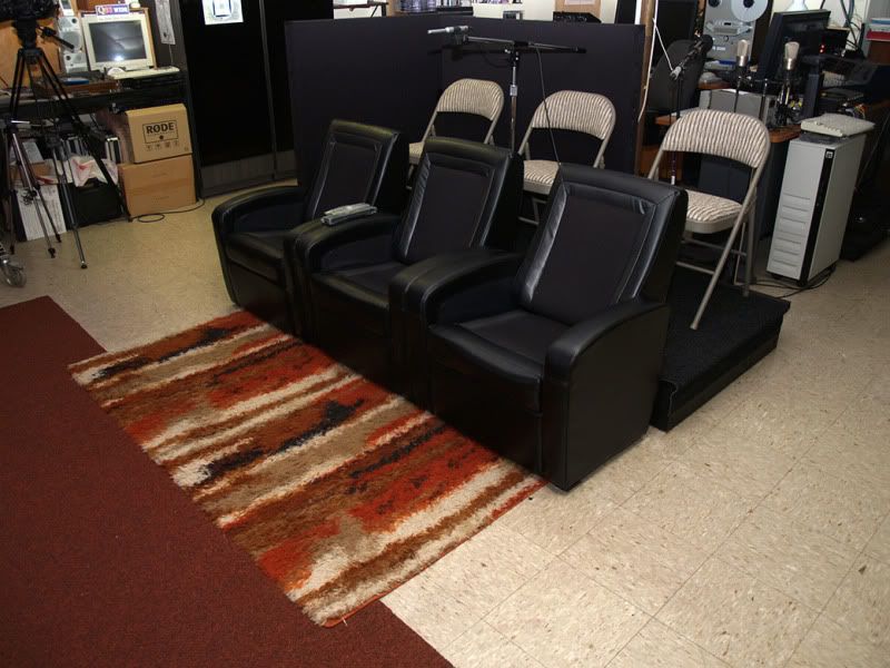

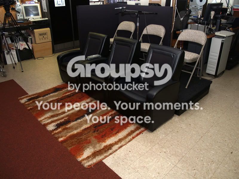

Here's a little update on the theater seating... still waiting for Costco to get those True Ottoman chairs in stock, if ever, so I had to substitute folding chairs for row #2 for now:
April has been unusually warm this year. We had 91°F yesterday and all the snow is gone!
"The quintessential "Bass Pig" experience.. the music starts a bass line, and a moment's terror ensues, like one is in control but not really in control, like the sensation of being on a rollercoaster that's just started on the biggest downhill dash.. Bass, a whole-body experience."
basspig
basspig
Now if Costco would hurry up and get more of these chairs in stock... I can't find them anywhere online. Been looking all fall and winter and come up dry.
Am thinking of making a very low riser for the front row (just 2") for the purpose of having a wooden surface to rest on. The vibrational experience for the back row is tremendous. Tickles the feet and shin bones! Would like to have some of that for the front row too... :D

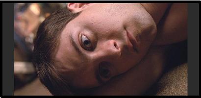

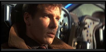

In my space, If I built a 2.35:1 scope screen I would not have the height of my old 16:9 screen. Thus I would sacrifice image size for the majority of my viewing material. The 2.05:1 ratio screen will give me large sized images for both viewing ratios with minimal amount of masking. Here's an example lifted from another forum of both 2.35:1 and 1.85:1 projected onto a 2.05:1 ratio screen.
