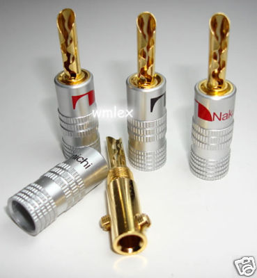

About the banana plugs I tried a couple different types, and I liked these (Nakamichi) the best. I liked the security of the 2 screws. The other types seem to come loose after time. Some blue thread locker may have cured that, but I never got around to trying it. They also make these in the spade configuration. I would only use them (spade style) on the speaker side though. Good luck!

Where did you buy these?

You can buy those easily all over the place on the web. They are pretty inexpensive.

Just as an aside, I avoid metal banana plugs. Not the bananas themselves, the grips. Heaven forbid one should get loose and short against the other one. That kinda defeats their purpose, IMNSHO.

I strongly do not recommend those. They're single-use bananas, because the plug is so easily kinked.
The "Nakamichi" plugs with the standard banana end may be fine, but the Z-tooth ones are just crap.

Ditto. My favorite bananas are still the 95-cent nickel-plated ones from PE. If they would come out with a series of those with double set screws I'd never have looked elsewhere...
