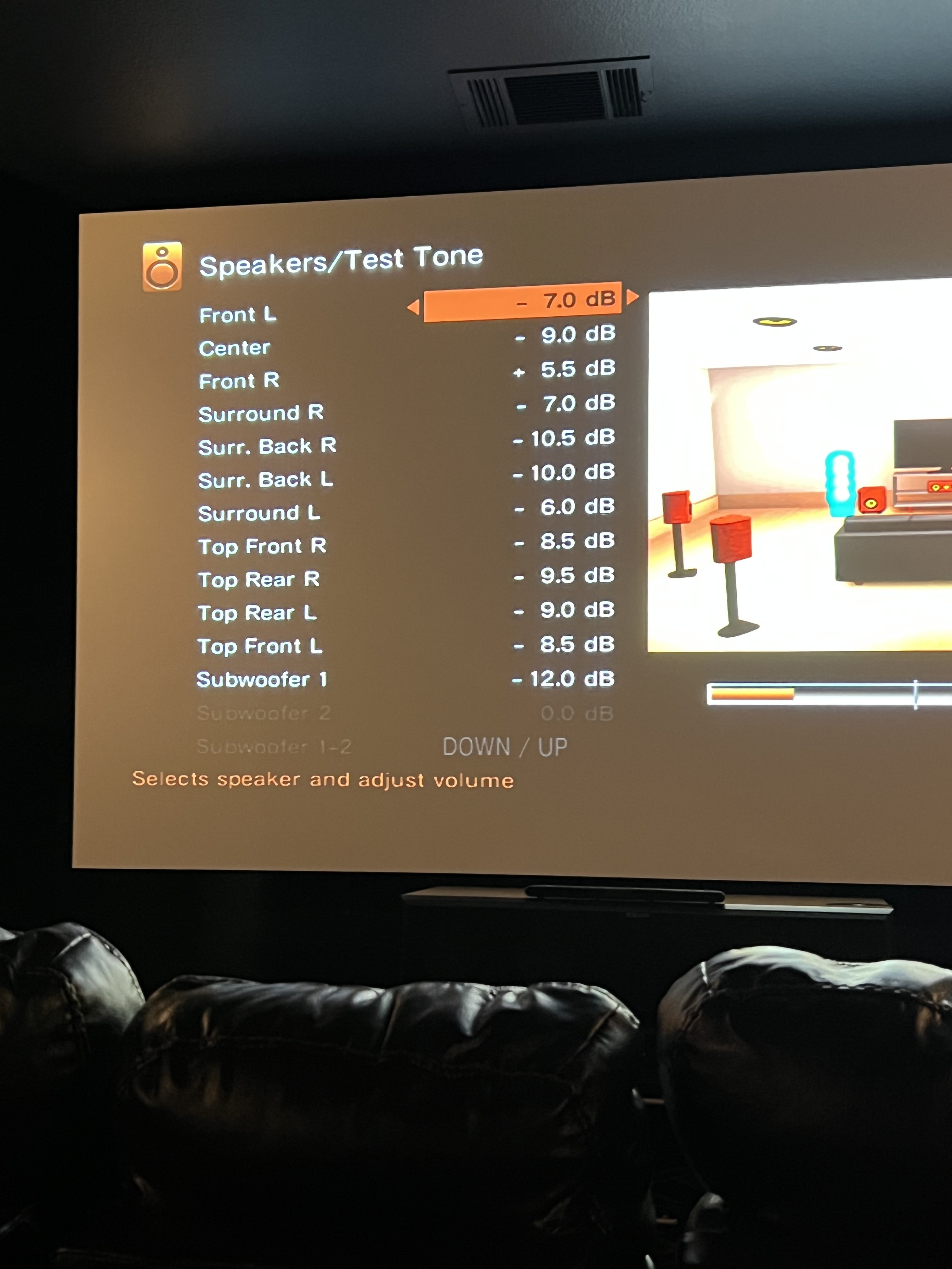

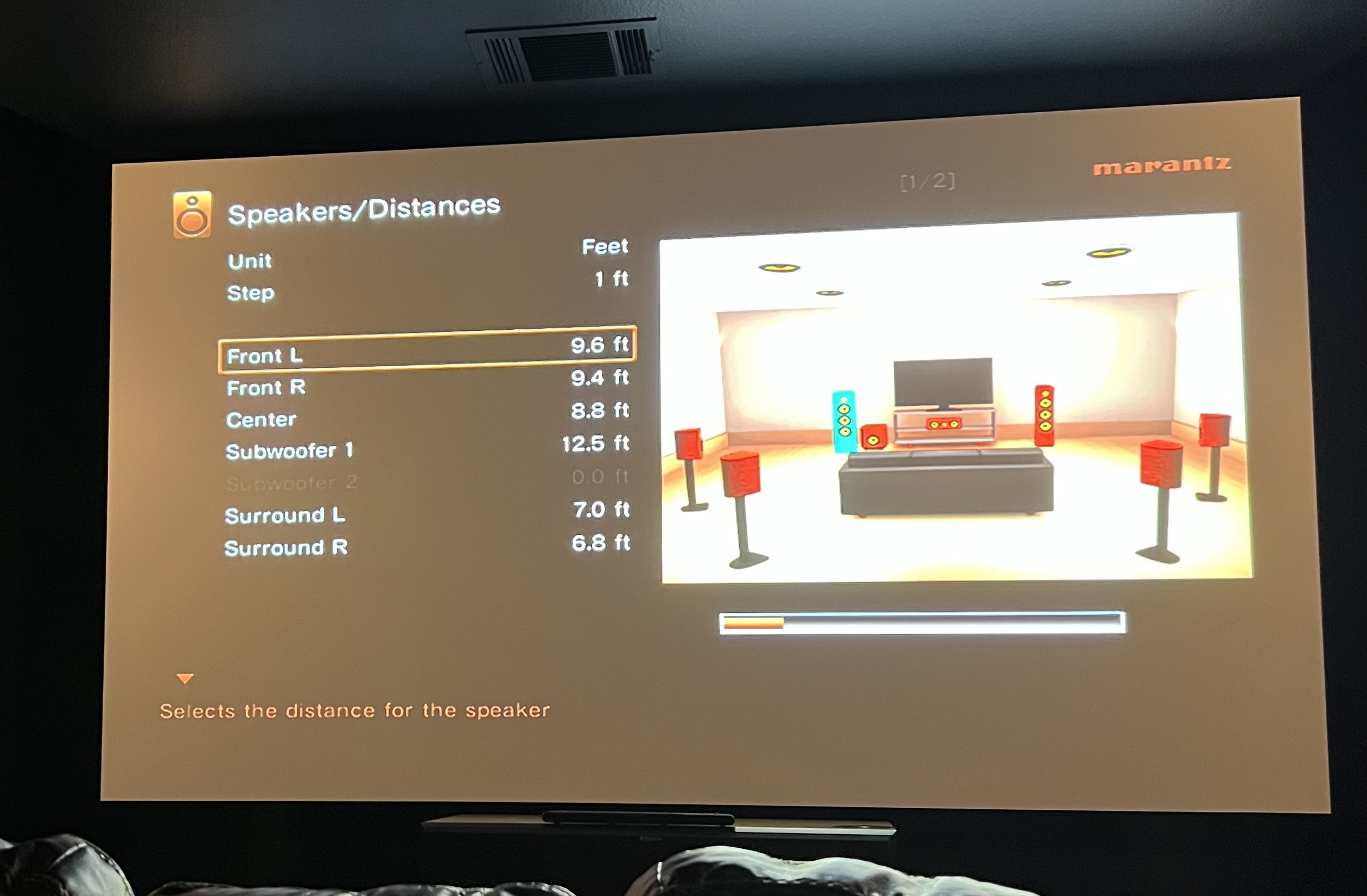

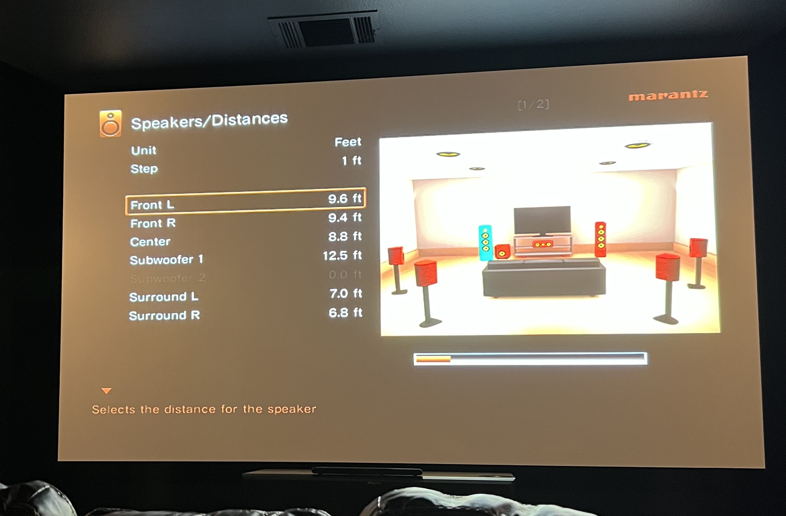

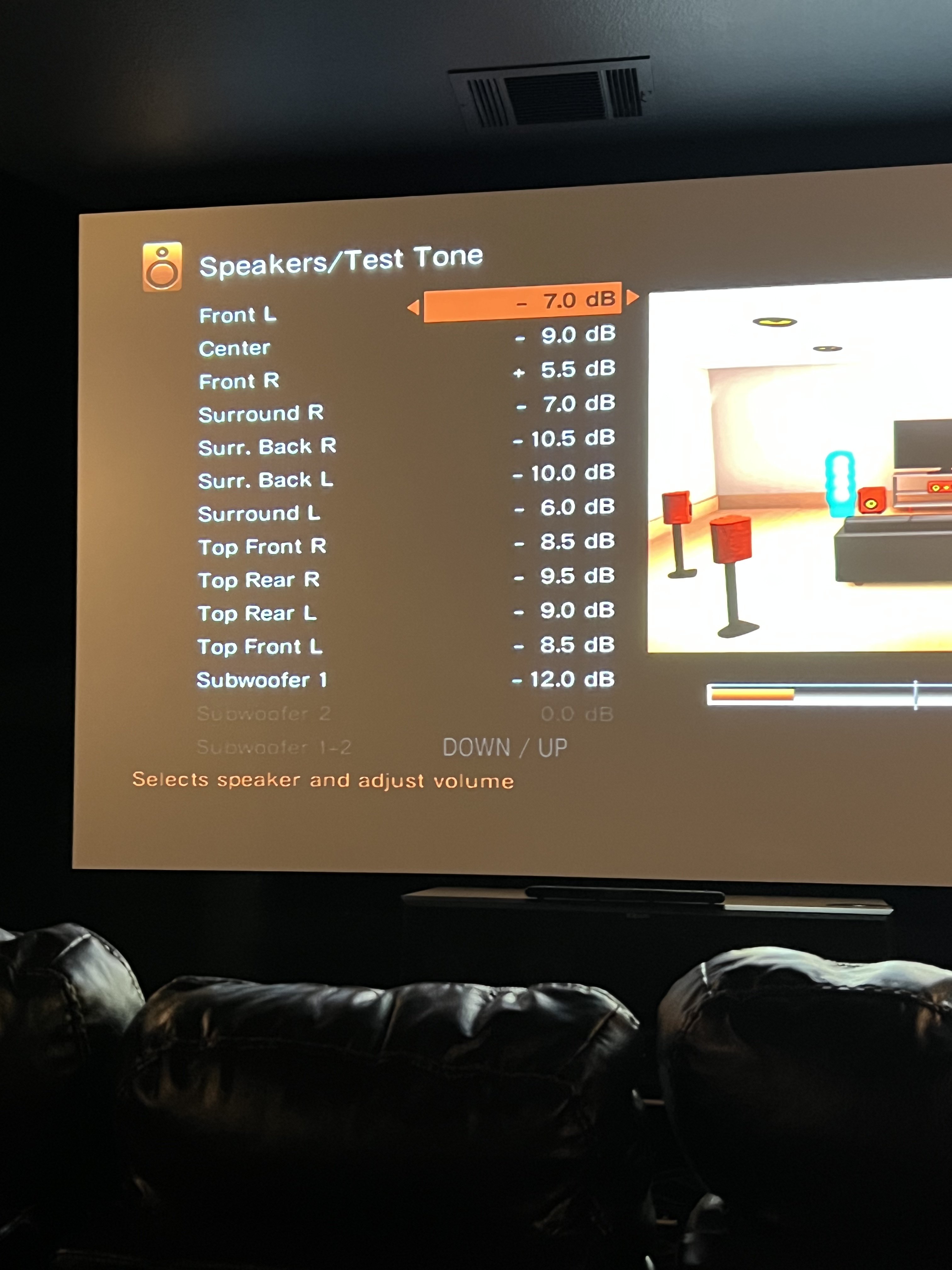

Today I decided to look at my audyssey settings and the distance settings look correct and are nearly identical to the left speaker. I also changed the output of the right speaker as you will see below to get it to somewhat match the sound output of the left speaker. I did this with a very low overall volume to ensure I do not clip.
Have the drivers gone bad as klipsch is saying to me because I underpowered them? Is the Marantz going bad?
Below are some screenshots of my settings which includes the output setting I changed to try to match the left front speakers output.

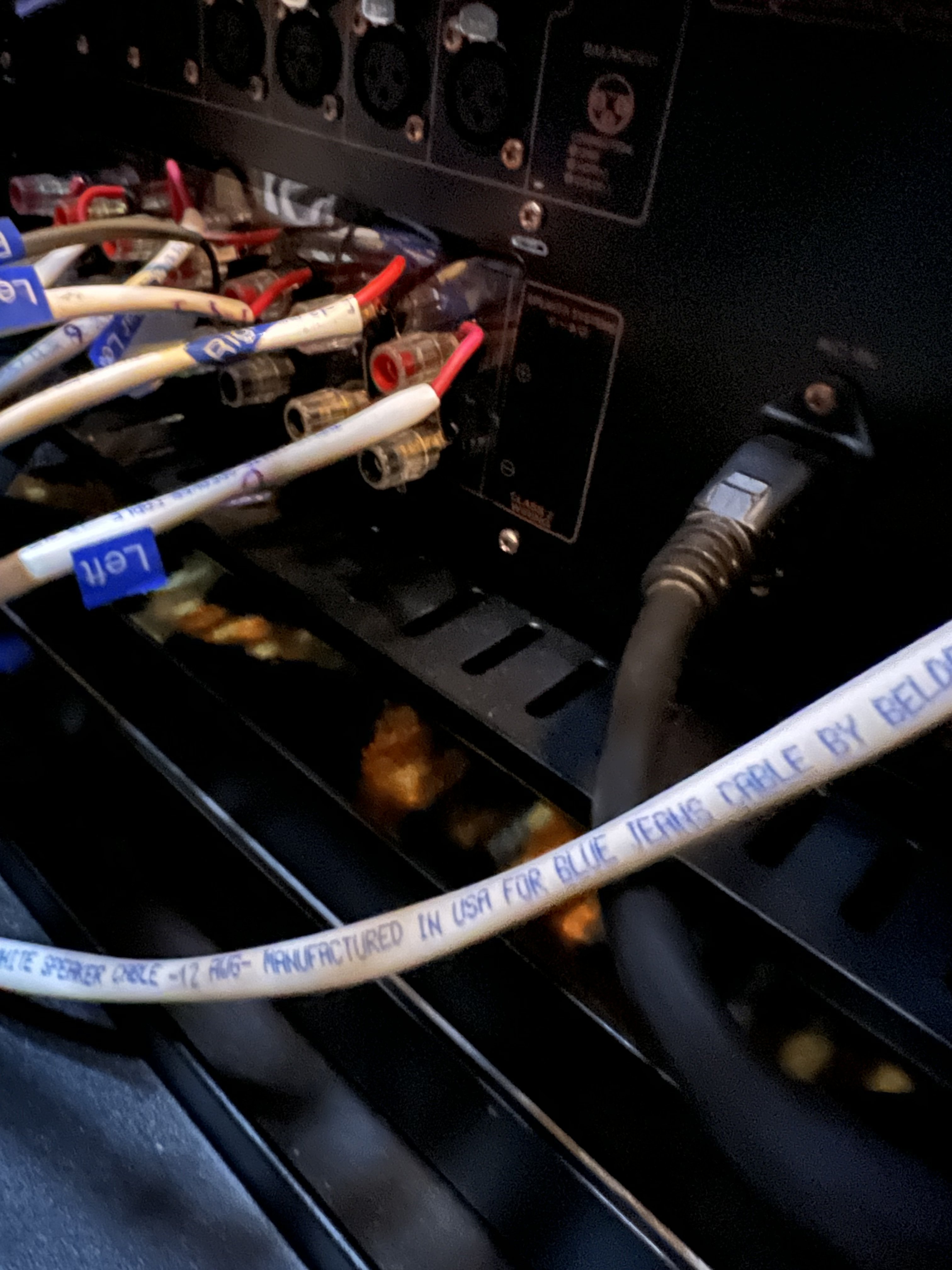

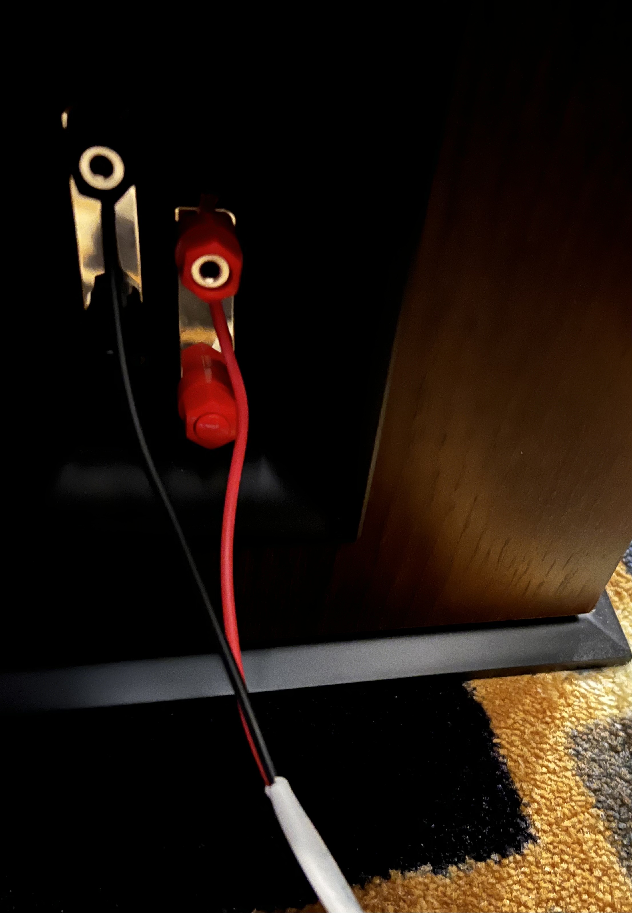

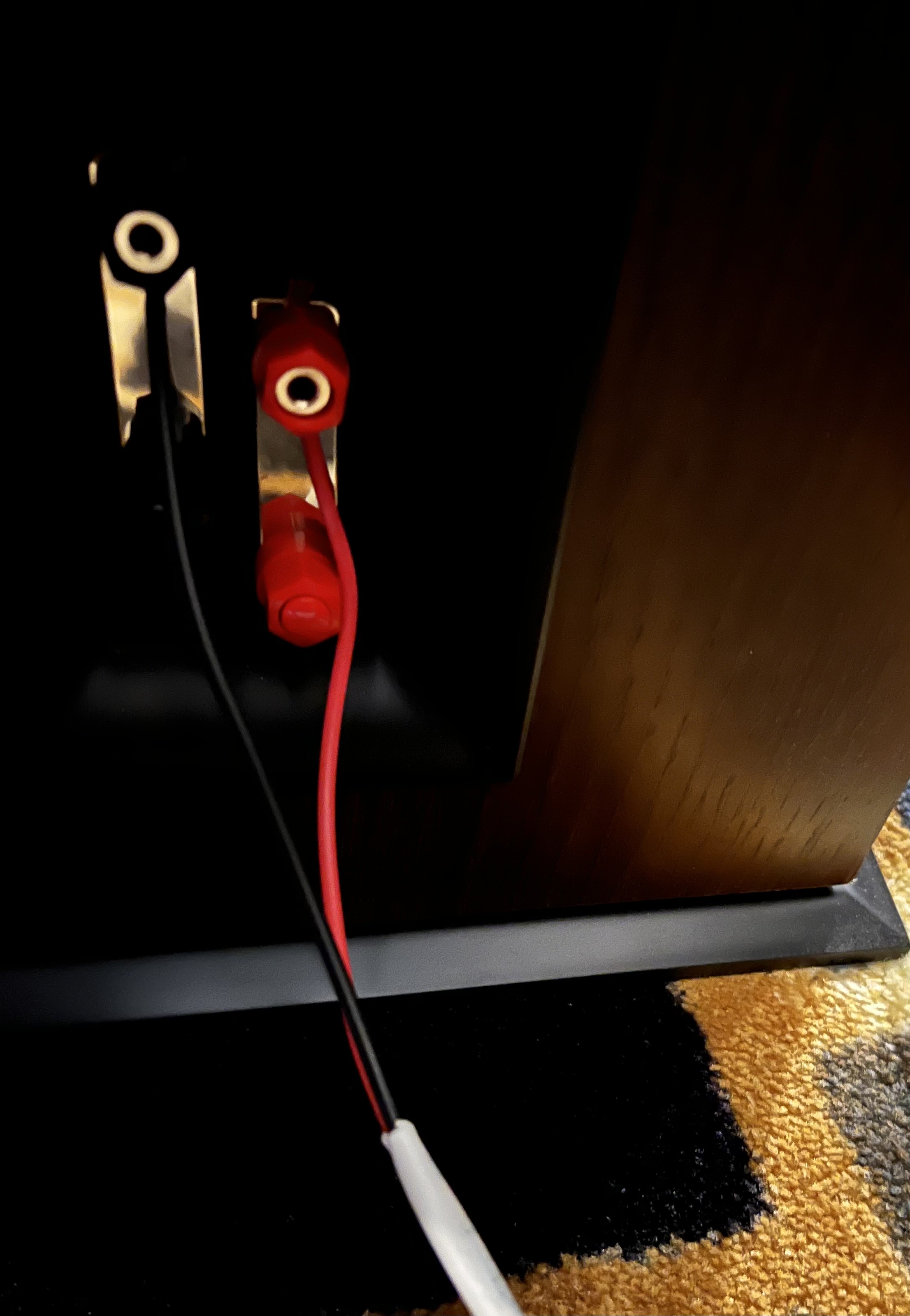

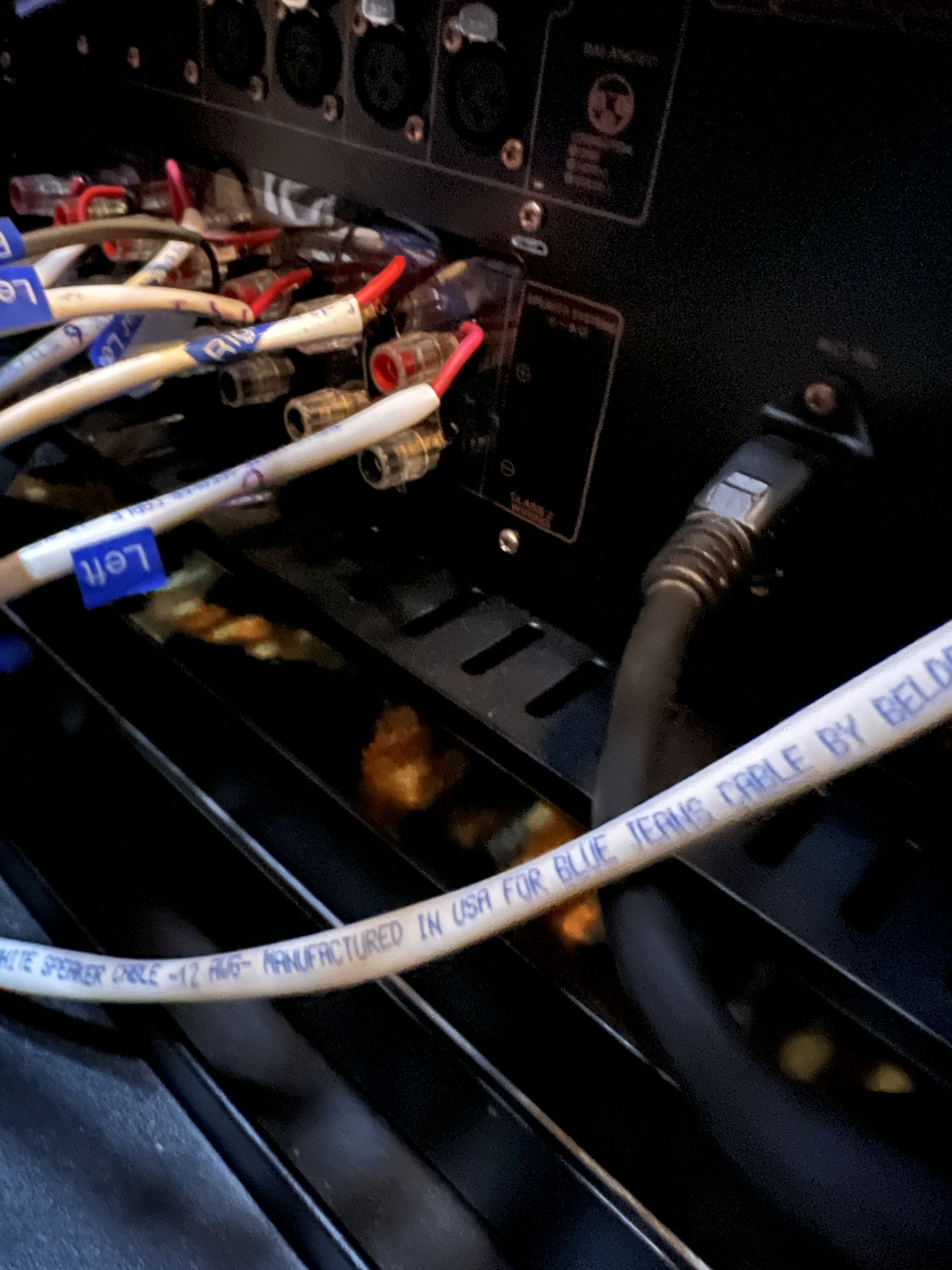

Here are pics of the cable hooked up to the speaker and also hooked up to the receiver.
I am not using banana plugs at the present but I am considering using them.
They are CL3 shielded because they are in wall cables.
The product is here (BJC 10 white 10AWG):
View attachment 59780View attachment 59781
CL3 has absolutely nothing to do with shielding and those aren't shielded- you would see a braided shield, foil or a stranded wire, often called a 'drain' or 'sink'.
I would also make sure the second set of binding posts is tight.
