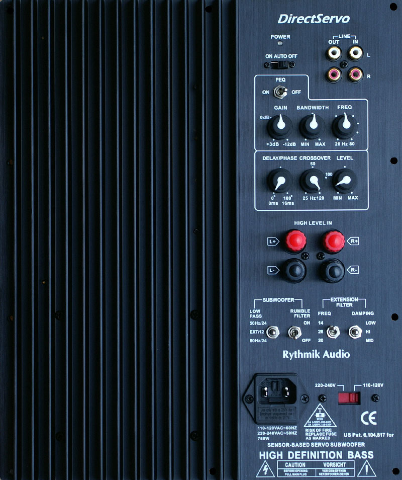

KEW
KEW
My Processor warns of setting up anything in between it and the Amp... You really think that's a good idea?
This is from the manual written by Outlaw...
"Additionally, some systems may have outboard subwoofer equalization equipment (such as a Behringer EQ or Velodyne SMS-1) connected between the PR-SC886 and the subwoofer. The signal processing performed by these units can produce a signal delay, and the Audyssey measurements will perceive that delay as a greater distance from the listening position. As a result, these systems will cause the measured subwoofer distances to not match the actual speaker placement. We recommend retaining the Audyssey-measured distances, as they include delays for both physical distance and for signal processing. For subwoofers with equalization built in, we also recommend disabling that equalization and using Audyssey alone; in most cases Audyssey will provide superior results."
This is not warning you against setting up one of these units, It is just explaining that Audyssey will compensate for the processing delay so you should use the "distance" settings provided by Audyssey rather than the actual physical distance. No problem, just let Audyssey handle it.
In the case of subwoofers with built in EQ, they are talking about where there is a PEQ built into the amp which allows you to select a frequency band and cut or increase the SPL at that frequency.
They are not talking about the case where your sub may have some EQ hardwired inside the amp (as most sealed subs do). Look at the top three rotary knobs and switch on this unit as an example of a sub with built in EQ:
