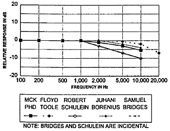

Ruler flat frequency responses have been shown [through various credible research studies] to be perceived as not tonally accurate in most [not all] source material. Rather a gradual frequency roll off is found to be perceived as tonally accurate - an example is shown below.
