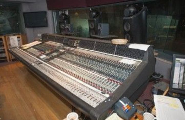

I do believe all the best recording studios in the world like Disney, Skywalker Ranch and Abbey Road Studios all use Diamond Series B&W. I mean that has to speak some volumes there about the company and product being put out there.
I'm going to go out on a limb and believe that Skywalker uses THX certified equipment. Best I can tell, that does not include B&W towers.

It looks like (and this is out of date now) Skywalker ranch used primarily M&K (THX certified) but used some amount of others (B&W, Blue Sky); possibly for marketing reasons
