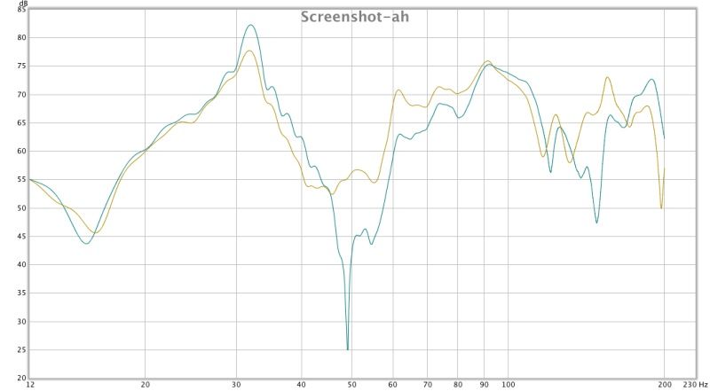

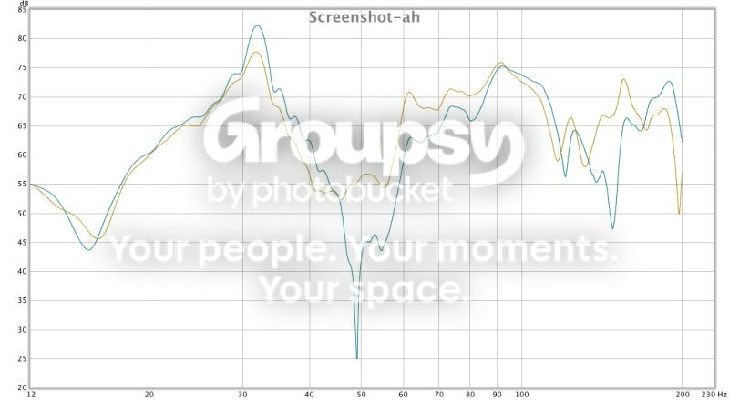

I just did an in-room sweep from 20-200hz. With my subs in place, at the highest deviation, my room measured +/- 21db. A total of 42db difference between the softest and loudest noise. :O I moved my sub a bit and within four minutes got that down to +/- 13db. A total of 26db between the loudest and softest sound. Not great, but getting there. The more subs I add the better the response will be. I'm fairly happy with +/-13db but I'm going to keep screwing with placement. :D I'm shooting for a total deviation of 20db, or +/-10db with two subs in place.
Above 126hz, my room does quite well. +/-2db up to 200hz. A total of 4db deviation. :cool:
Between 85hz and 116hz there is a very severe dip. If I were to discount this dip, the response would be 18db total deviation +/-9db. :)

This is a screen shot of my room. The nasty green line is at 5 1/2 feet from the rear wall in my sitting position. The brown line is at the ideal sitting position as recommended by Bryan from GIK acoustics which is 6.8 feet from the rear wall. I am currently working with him to get a better frequency response in my room. Mind you, this room is carpeted, has 2 soffit traps in the front corners, 2 244 behind the speakers, 4 242 at reflection points in the side walls, and 2 monster bass traps behind the listening position on the rear wall. I just ordered 4 soffit traps for the rear corners. It's a work in progress….:D
That is exactly my experience; inching the sub around made remarkable differences in the smoothness of the bass response as measured in my seating position. I suggest that you keep experimenting, it took me hours of time over several days to find that one sweet spot. If only we could see sound waves.
