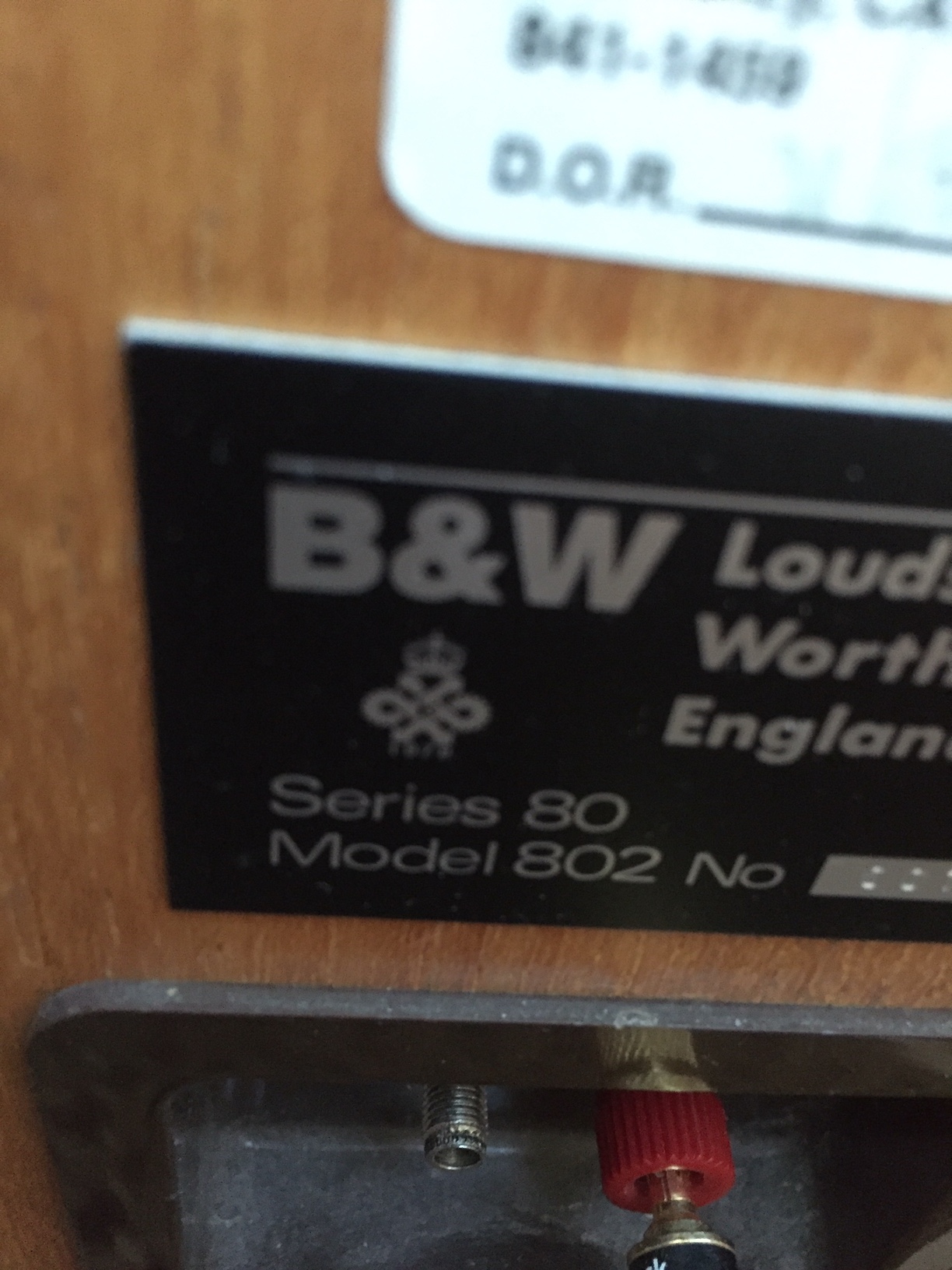

Hello,
I'm trying to find the threaded plastic banana plug cap that screws onto the terminal post... no luck so far. B&W does not have parts for this 802, Series 80 speaker. In the photo you can see the red one, with banana plug inserted-- I need the black one. Does anyone have sources for parts for these older speakers?
Thanks!

Finding a black plastic cap to fit what you now have on your speakers may be difficult. Binding posts like yours don't appear to be made anymore. But it shouldn't be difficult or expensive to replace those binding posts with new ones that fit your existing terminal cup. Many are available:
Binding Posts:
Madisound has many different makes. https://www.madisoundspeakerstore.com/binding-posts/
I'd avoid the expensive ones and focus on the Bennic/Yung brand. They're gold-plated brass, made in Taiwan, very good quality. As a guess, these binding posts might fit your terminal cup:
https://www.madisoundspeakerstore.com/yung-binding-posts/posts-g-postb-binding-post-black/
https://www.madisoundspeakerstore.com/yung-binding-posts/posts-g-postr-binding-post-red/
They're $2.75 each, order black or red separately.

OK- Thanks! I've ordered a couple of these and will see if any of the cap screws fit my existing post. Assuming they don't fit--does anyone see a problem with just using the existing post with banana plug connectors? The banana plug fits inside the cylindrical post, and so it's not obvious to me why the plastic cap would be needed, Amy I missing something?

I don't see any reason why you couldn't use it without the missing black cap screw. It may not be up to the latest so-called safety standards that call for insulation covering the terminals on new speakers (see photo). But as long as you know which terminal is red and which is black, you're good.

Perfect! Exactly what I thought. Fortunately I have some black electrical tape to keep the Nanny State folks happy!

Again, thanks for the input. Not sure exactly what " I'm pretty fed up with the current generation not having the most elementary of skills" means.... While it's true I've never changed speaker terminal posts, and would be hesitant to do so without a clear idea of what I was doing (I'll look again, but didn't see how the cup comes off the back of the 802s...) I was building vacuum tube radios and computing "machines" on "breadboards" before some of the members of this forum were born.... So, if someone has a procedure for changing the cup/terminal on my specific speakers I'm all ears....
Are you telling us there are no visible screws attaching the terminal cup? I can not tell that from your picture if that is so. I have never seen that before. I did look at the service manual and it does not mention anything about removing the terminals. If it was odd I would have thought it would have.
I can tell you how it got broken. The EU have long had a rule that plastic plugs have to be put in the terminals to stop people using Banana plugs.
These have to be put in speakers power amps and receivers. They are very hard to remove and not supposed to be removed. Trying to can damage the terminal and break it.
Most terminal cups are attached to the back of speaker cabinet with 4 small screws. As an example, see the front & rear view of a terminal cup here. The rear of the cup includes a rubber gasket. The rear view also shows how simple it is to detach old binding posts, and attach replacements.
If your speaker's terminal cups lack screws, they may have been attached by a press-in type fitting. They will have to be pried off. Considering their age, the rubber gasket will probably not come off clean. That's why TLS Guy suggested replacing the entire cup. But before you order replacement cups, you must know the diameter of the hole in the back of the speaker cabinet where the recessed cup fits.
