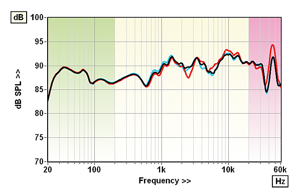

Here are the measurements obtained by the UK magazine Hi-Fi News. This is a highly reputable magazine and has been around for over 60 Years.
This is the FR.
I would not be happy at all from measurements like that for a design of mine. I would regard trying to obtain that sort of cash for a speaker with those measurements as unethical.
This is the FR.

Unlike measuring AVR/AVP/Amps, you need to compare speaker measurements from the same measurement source, not your or your friend's in-room vs other sources.
If the 800D3 were measured from the UK Hi-FI News source, it would probably look very similar to the 801D4.
The reason I say this is because it seems every generation of these B&W 800-802 (D1-D3) look very similar depending on the source of measurement.

Above the transition frequency and with competent measurement gear and method l, I don't see an issue with using others measurements.
Are you saying that the same speaker will have about the same/similar frequency response in every room (TLS Guy compared his in-room response to the published measurements) ?
Any change in microphone placement will change the results. Different types of microphones. Different room acoustics. Outdoor vs indoor. Different measurement technique.
I am sure @shadyJ can elaborate as he does speaker measurements all the time.
I've seen the same speaker having significantly different frequency response from one source vs another.
I think it was the NHT SuperZero. I think Home Theater Magazine had +/-0.9dB. I thought, "Wow!". And then I saw another Magazine had a response of +/-3dB or something like that. So huge difference.

The microphones should all have compensation files, so they should all be measuring the same result. Room acoustics should not be a factor since no one should be measuring in a room, or at least publishing results where the room reflections can not be windowed out.
But techniques matter a lot. Where is the mic with respect to the speaker? Near-field? Ground plane? Free air? 1 meter? 2 meters? Level with the tweeter? On a different reference axis? That will all change the result. Furthermore, some speakers aren't made to be used with the tweeter aiming at the listener directly, so then the tweeter would be the wrong reference point.
Well, no one should be measuring in a room for PUBLISHED results, which is also my point.
TLS Guy compared his IN-ROOM measurement to the Hi-Fi News and Stereophile PUBLISHED measurements.
I would say that my measurements and the ones above agree very closely. Both show a tendency to rise around 10K. I doubt the differences in that region would be audible.
In the regions below 200 Hz you can not draw conclusions with in room quasi anechoic measurements. However again our measurements are more similar than different. I would say that from my listening opinion, the B & W 800 D3, is just very slightly "plummy" in the bass. But then I am used to TLs which avoid that problem pretty much universal with ported speakers.

My measurements were 2 meters, point at the center of the head. The blue is axis, and then 15, 30 ,45 and 90 degrees off axis.
The B & W 200 D3 you certainly can not call a bad speaker by any stretch, by listening or measurement. Actually they are the best B & W speakers I have heard to date. More often than not, I come away with a negative impression of B & W speakers.

I'm saying that the room will not have more influence.
Edit: my comment on methodology as well... If that is followed, the room issues will show up clearly and be understood.

You are absolutely correct, if you have a trusted known reliable set up. However you can not rely on measurements in the last three and a bit octaves, (200Hz or so) with quasi anechoic measurements.
