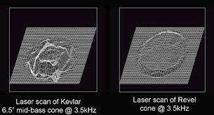

Do those 703s have the infamous yellow Kevlar mid-range driver? At that price, they probably do. If so, my short answer is don't buy them.
In the long run you will not like them, and put them up for sale. Their bass is far from tight sounding, but that can easily depend on the room they're in, where they're located within the room, and where you are located too. Their upper and mid range sound will be too bright sounding. It may seem tolerable at low to moderate volume, but at higher volume they will sound harsh, ear-fatigue-inducing harsh.
While it is true that used B&W speakers do sell for decent prices, it is also true that many B&W owners become disappointed with their speakers. The used speaker market is full of them. The main reason is those yellow Kevlar mid-range drivers. They should never be crossed over to the tweeter at such a high frequency of 4,000 Hz. They make harsh noise at that frequency. B&W has tried a variety of ways to suppress that noise. Most of those efforts don't work well, except in the much more expensive 800 series speakers.
Here is a visual comparison two mid-range drivers producing a 3,500 Hz signal. On the left is an unnamed (B&W?) yellow Kevlar 6.5" mid driver, and on the right is a similarly sized driver made by Revel. The cone of the left is clearly in what is called 'break-up mode'. I'm rather certain people would not like its sound.

Those 6.5" B&W Kevlar mid-woofers can sound awful if they're driven with the frequencies that stimulate a resonance in that ~4 kHz range. Once I learned to notice it, I could never unhear it. It's downright ugly sounding. Even at lower, more tolerable volumes, it becomes irritating to my ears.
I've heard that problem in all the 600, 700, and CDM series speakers I've heard. Only the B&W 800 series speakers I've heard manage to avoid that. I don't know whether B&W achieves that with different drivers, or whether they use more elaborate filters in the crossover to block the noise.
… However, you can see there is a rise in response of the midrange on axis, and it really looses it right at crossover. Because of the break up you can see there is beaming on axis. However, if you combine those responses, then the in room response is probably reasonable.
That frequency response curve only shows loudness vs. frequency. It doesn't distinguish whether the sound at 4 kHz is due to the audio content, or if it's from the Kevlar driver's break-up resonances.
