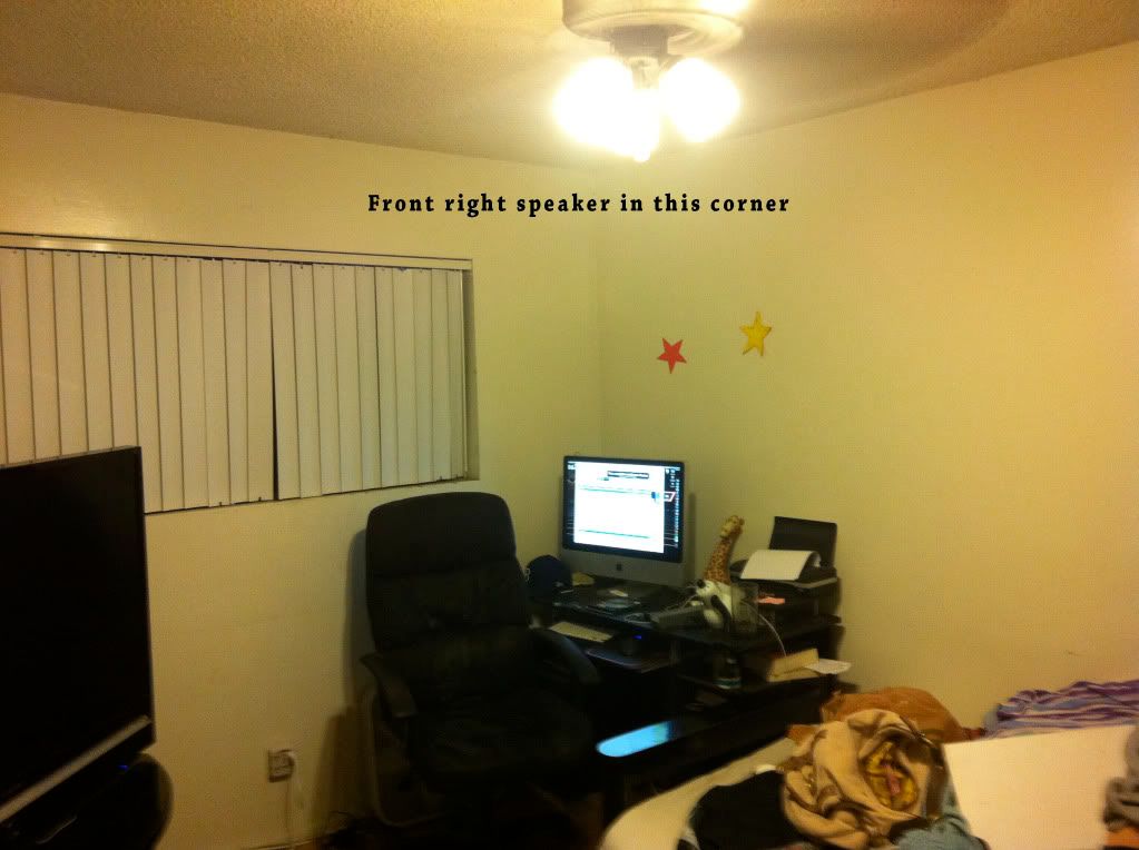

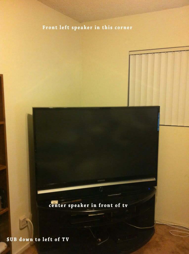

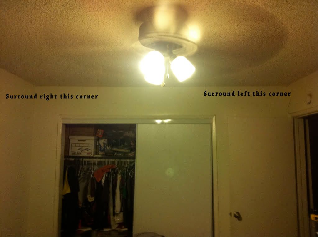

Sorry about that I went to dinner with my girlfriend. Anyways I took my surround system back to Best Buy for the time being so I can only give pictures and locate where the speakers would be.
Keep in mind I am facing the TV head on, so in essence the front left speaker is directly in front of me and the surround right is sort of behind me... I really cant rearrange because of the little space I have it makes it nearly impossible.

The *very max* I would recommend in this room is 2.1. I did say very max, assuming that the layout remains the same. Otherwise, TBH, my first recommendation is to just use the TV speakers. Or perhaps something in between the first two ideas, and a 2.0 rig. Forget surrounds. Forget center speaker. Forget left speaker being center and above (wtf). (edit) or the right speaker placement. what in the world . . .
sawzalot
sawzalot
I agree just go with 2.1 setup no surrounds, I would definitely try to get the speakers to the left and right sides of the TV if they are too big sell em and get two tall narrow fronts only, that speaker behind the TV is completely useless at this point unless you need it to put a plant on top or something like that but for sound quality well there will be none to speak about.I like scrabble , kewl game.

Well let me ask you this... what if rather than rearranging my room, I just put the speakers in different locations that would make them head on in a digaonal fashion?
So for instance put that front left speaker actually to the left of the tv on the wall facing me rather than in the corner... and I did that for all of the speakers so I basically make it like I am with a straight setup except it is diagonal.

if it were me. i would get a small speaker system, say 6" 2 ways. put the mains right next to the tv, and the center right on top of the tv. or no center. and experiment with the surrounds.
or
a nice speaker bar. i heard some of them sound pretty good.
and a small sub somewhere.

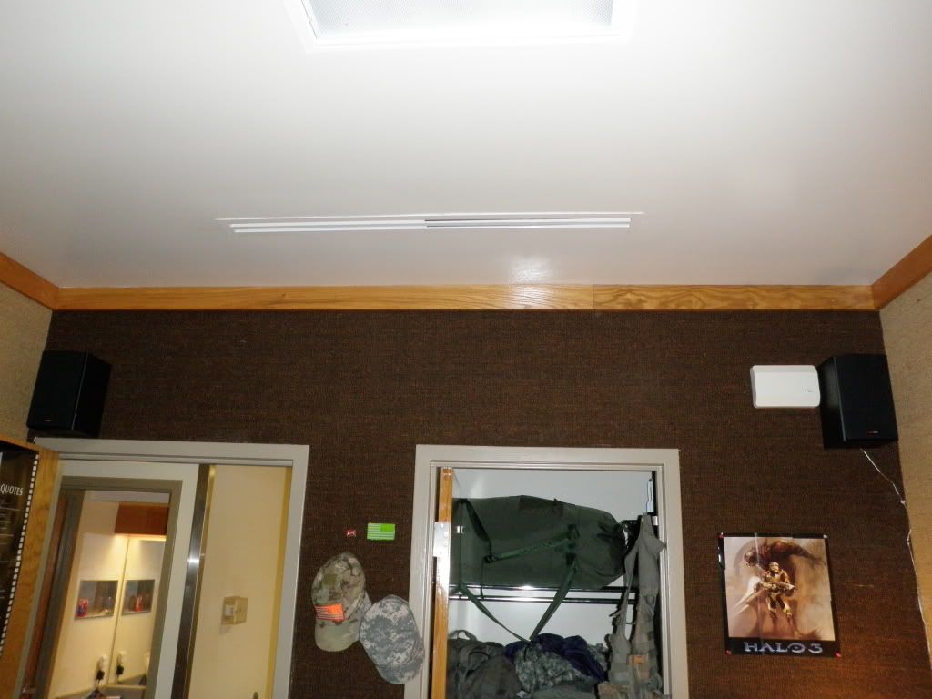

I agree. You can put a 5.1 system in any room...
Its all in how you arrange then set your speakers. That was my room in Hawaii before I deployed to Iraq earlier this year. I used the calibration mic that came with my Yamaha receiver and it turned out pretty good, I used the results from the calibration and then played with it further. It took some time but I finally was able to set it up the way I wanted it. You will have to rearrange your stuff though.
