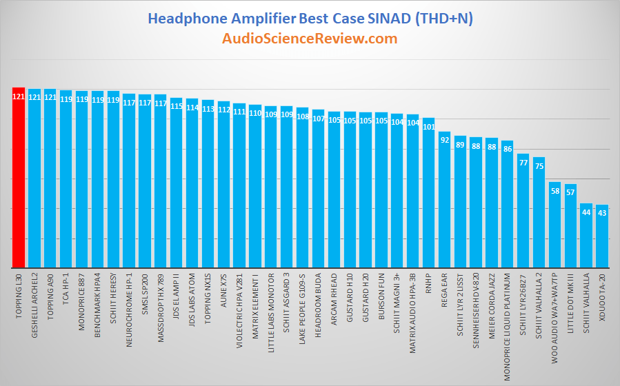

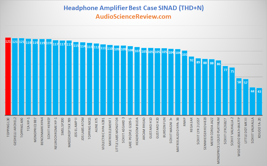

I don't think Outlaw is very serious about their published specs as some of them seemed confusing and contradictory. I had to email for for clarifications before and got different answers from two different email correspondence. If you end up going with their products, I would suggest you insist on getting a response directly from their engineering/design team.
For preamp, if I need one now I would go cheap and get one of Topping's such as the $150 L30, or the higher end Pre90
Topping L30 Headphone Amplifier Review | Audio Science Review (ASR) Forum
Topping Pre90 Review (preamplifier) | Audio Science Review (ASR) Forum

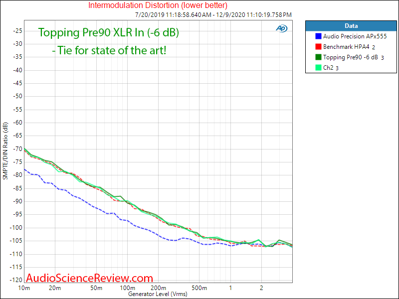

Time to switch to balanced!!:) It won't give you better sound quality, but neither would the 120 dB SINAD, but you will feel good about the ease of making good connections, and the flexibility to use longer runs.
Amazon prices:
Amazon.com: Topping Pre90 Preamplifier & Ext90 Input Extender Hi-Res Audio NFCA Modules 2RCA 4XLR Combination (Silver, Pre90): Home Audio & Theater
$249.99 for the extender
$599.99 for the Preamp
With the balanced outputs, you can pair it with the Bench mark AHB2 and you would have a pair of separate amps that offer the best possible specs in THD+N, IMD, SNR, etc.. that money can buy, all for under $4,000.;)
It has one of the best looking IMD (the more offensive form of distortions) graphs on ASR, tie for SOTA, with the AHB2:
Amazon prices:
