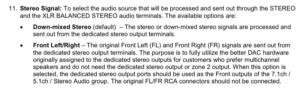

I’d make sure Volume is Fixed in the Oppo and DRC is OFF. Match your crossover settings in the player and receiver and use the two channel R and L analog ports in place of the FR and FL analog ports in the 7.1 section per Oppo.

Doing that will only match the front L/R channels where I am using 5.1.
The front Left/Right channels can in the settings in the Oppo can be assigned to the front L/R output in 7.1 analog out but I prefer to leave them as default for when I play stereo CD disks and connect these to the CD input on the AVR.
