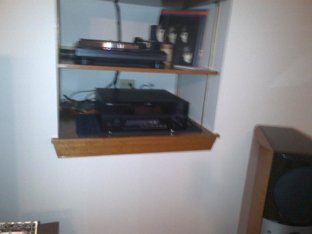

Sorry about the pic but as you can see it's well ventilated, I doubt that was the issue. This has been it's home since I bought it.
The Yamaha tech even "intimated" that there is an issue during our troubleshooting session. He didn't admit there's an issue overall but that they did see a higher incident of failure on HDMI circuit boards than all the other boards. And yes, I've been in many a home where people stack all their components on top of each other. :mad: Maybe they're the people who are posting reviews. :eek: Hmmm. :rolleyes:

I highly doubt it's an issue, but the only thing I'll point out is that without an open back, the hot air is probably getting semi-trapped in the back there since that's where a lot of heat from the HDMI board is. It's probably only a difference of 1-3 degrees compared to an open back rack, but it could have been a factor. Odds are there is an actual issue with the board, like the impression you got from the tech indicated.
Just to be safe in the future, I'd probably add a fan to the top of the unit just to keep air circulating in and out of the space, plus it will help cool the actual components inside the unit which should help prolong the unit's life.
