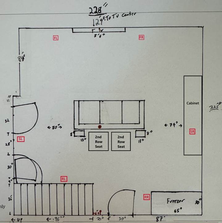

Room is about 19’ deep and 20’ wide, 7’ tall. TV and Main listening position (red dot) are shifted due to space constraints (that’s the only place the TV could go. As a side benefit, the banister rails of the rear stairs act as a fantastic bass trap.

I updated the original post to show room layout and sub.
I generally at the listening position dialogue is 65db and perk is 93db. Louder than that is not comfortable. Listening distance for the speakers is about 8.5’ to each speaker. Currently I’m running a 7.1 setup with a Denon S760h at 60/98 volume and that’s perfect for me. Their website says:

The height speakers are actually going in at 30 degrees for an Auro 3D style design (I just prefer that). However, 30 degrees overlaps with atmospheric specification range.
