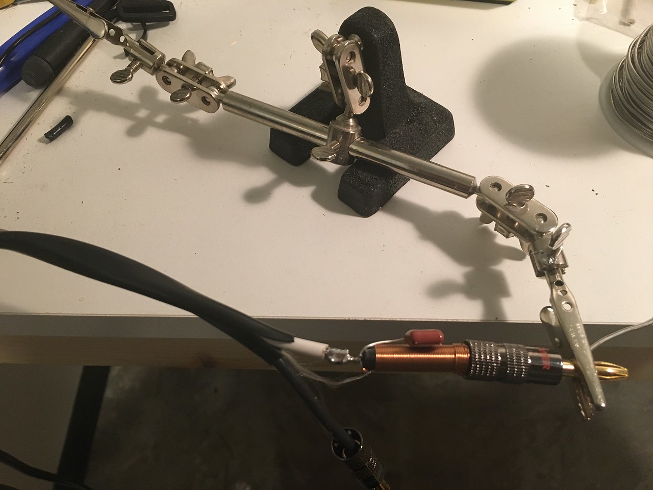

You need to buy one of these for each speaker.
We had a member having a Spanish language radio station coming loudly though all his speakers this last July. This was being picked up in his speaker leads. He was not able to build the rejecter blockers specific to the frequency of the offending radio station I designed for him, so I built them for him.
You will not need a cap I don't think, just the inductor.
So if indeed the pickup is in the speaker leads, which is most likely, that will do the trick for you.

The inductors go in series with the +ve wire to each speaker at the +ve terminal of your receiver.. To avoid shorts I recommend you use that terminal strip like I did and wrap it with electrical tape. Try that first. It may do the trick. If not a tuned RF rejecter circuit will have to be designed for that tower.
