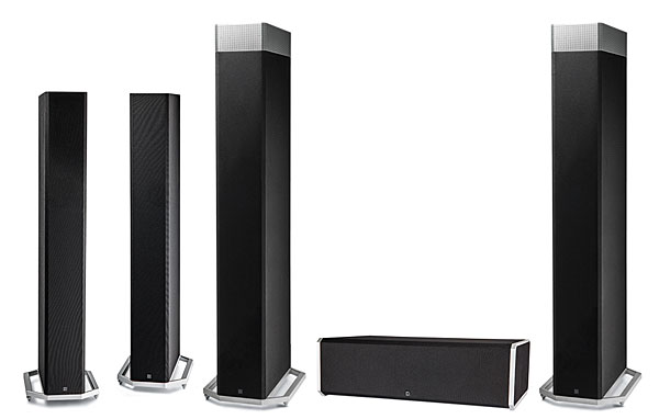

Just wanted to chime in to get a second opinion. I'm a newbie and don't have disposable income. Just bought a dedicated amp to run my towers, center, and surround L/R when before through my Denon 4300H. Now my avr only powers the surround rear L/R n four atmos speakers. And with this dedicated amp, isn't it giving the towers, center, n surrounds the right amount of juice to perform at a high level or did I just waste my money? Thx
Which towers do you have? Brand and model? Size of your listening room and your listening distance from the towers? Also, at what loudness do you listen to your HT system? Those are all factors that will let you obtain the proper answer.
See the following link for calculation: http://myhometheater.homestead.com/splcalculator.html

Def Tech Bp9080x towers
Def Tech 9080 center
30x30ft room
Towers are 9.2 ft from listening position
What you mean by what loudness? Appreciate the help

How loud do you listen to your music and movies?
Your BP9080x towers are powered speakers. As per S & V review, at your listening distance from them, you definitely don't need external amplification with those DEFINITIVE Technology towers:

Your room size would suggest an external amp might help, but if sitting only 9.2 ft from those towers, your receiver can easily drive them to give you reference level.
Which amp did you get anyway? You need a 200 W rated amp to gain a little less than 3dB of sound pressure level.

The ext amp I just got was the Monoprice Monolith 5x200w
Before the 5x200w, volume knob had to be at 68 - 70 at least for my liking.
Denon says the 4300H model outputs 125w per channel 8 ohms but really how much was I getting when all my channels was plugged into it??
If you calibrate the avr with the new amp properly the volume reading will remain the same for the same volume level as before. Each channel in your avr was capable of 125 watts output at any given time as each speaker's needs demanded, which likely wasn't that much at any given moment. Your new amp's 200wpc gives you about a 2dB advantage over 125wpc at 8 ohms. Try using the spl calculator Verdinut linked earlier to see what your demands are at a given time.
If you are referring to an all channels driven simultaneously spec try this https://www.soundandvision.com/content/denon-avr-x4200w-av-receiver-review-test-bench but such a spec isn't all that meaningful in general use.
Just take a few seconds and play around with it, it can be a real eye opener as to realistically how much power you might require, and just how much more it takes for small, incremental gains.
