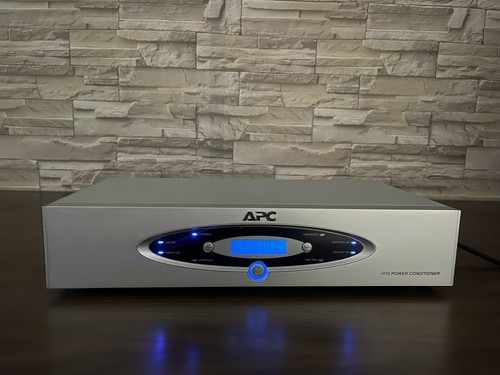

I have been using the APC H15 power conditioner for about 15 years. It's a very sturdy and reliable product. It protects equipment from surges. You can get a used unit from a reliable seller here:
If your equipment to be rack mounted does not draw more than 15 amps on a 120V line, I have no hesitation in recommending it. It is rack mountable. Perhaps you could ask the seller if he has the rack mount ears. Otherwise, you could contact Schneider Electric (Owners of APC) for availability.
Should you prefer a new unit, you could check for the H10 model. It's also an excellent surge protector but it will cost you more than your planned budget.
