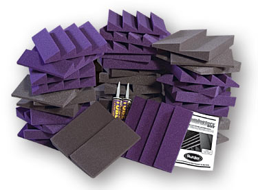

I ended up going with DST D36 Roominators System. It contained 36 1'x1' pieces. I got the burgundy and grey colors. I did not get any bass traps yet. That is still going to happen along with taking care of my ceiling. Im on a tight budget living in San Francisco and paying ridiculous rent. The total amount of money spent was 120.00 with velcro. I decided against the glue substance they include with the kit because I was afraid of what it would do to the walls.

Hope this helps. I attached a pic of the kit I purchased.
