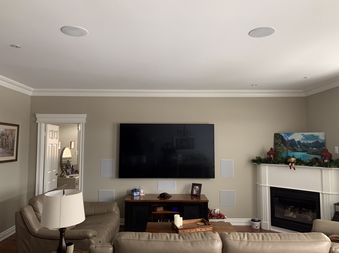

Hi all, Terry here from Toronto Canada and I’m a big fan of audioholics here. I am finally building my home theatre system and now I’m just waiting for my AVR-X2700H to come in but in the meantime I’m doing some homework on the audyssey set up. I have my centre, left ft and right ft all in wall, now below LF I have an in-wall sub and below RF there is a in-wall sub, both subs are passive. I also have my left and right rear surround bookshelf speakers as well as a L & R top middle in the ceiling. My question is that because my subs are passive I am using a Dayton Audio SA230 amp to drive them via my pre out on my Denon...can you advise me on the amp assign set up for my scenario ? Thank you in advance.
