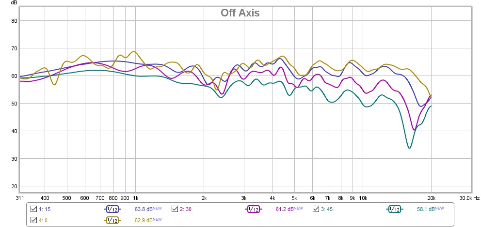

I don’t know what you’d consider “flat”, but I do know many studio highly accurate monitors achieve around +-2dB anechoically, for the Klipsch to achieve that on axis, and a +-45 degree off axis response (-6dB) at +-3dB 1000hz-14khz, I’d consider it highly accurate.
If a speaker with a sloping response off axis (ie most of your run of the mill 2 way direct radiating speakers with 1” dome tweeters) is equalized flat in the far field, you will end up eqing the direct sound with a rising treble response and it will be extremely bright sounding and certainly not accurate. Our ears first hear the direct sound and then combine the reflected sound with it, in addition, unchanging aberrations in response are “filtered” psychoacoustically, IOW, our brains adapt to the response variations introduced by the room, effectively ignoring it after a few minutes of listening. Ever worn a pair of crappy headphones for awhile and eventually notice they don’t sound as bad after a few hours of listening? Same idea. A microphone and frequency response measurement does not differentiate between the two, since a majority of the off axis sound bouncing off the walls and ceiling has a response that declines rapidly with frequency above 4-8khz, the mic will see a sloping response from the combined direct sound and “rolled off” reflected sound. A speaker with a waveguide that gives uniform directivity that doesn’t change significantly with frequency will not have a sloping off axis rolloff, rather, the off axis sound will simply be attenuated across the entire band that the waveguide controls directivity. The original graph I posted is a far field measurement that is a combination of the reflected and direct sound along the gold 0 degree line. As you can see, the combined in room response (ignoring the weird dip at 2.5khz) is -5dB, +3dB, and only begins to roll off at 14khz, where the waveguide fails to control the dispersion at the top end.
Eqing for a sloping response used in the original Audyssey target curve simply dulls the direct response of the speaker. I may try playing around with the multeq editor and see if it will allow me to create a curve that slopes above 14khz, since the flat setting would likely lead to an eardrum piecing boost from 16khz-24khz. Either way, what’s the point in EQing what is already an impressively flat far field response above 500hz?

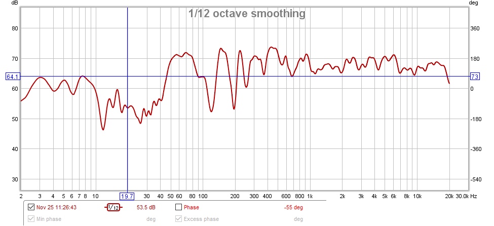

I do need some minor correction below 80hz. I have a very small (3dB) bump at ~ 50 hz but the bass above 80hz up until about 200hz is pretty whack. This is an older measurement but still applies
Multiple subs wouldn’t be able to solve the erratic behavior in the mid bass because it would require a 200hz xover, even with the sub placed dead center between the mains, not be localized, even a 120hz xover I was forced to use with a pair of Polk satellites at one time sounded bad, like the mid bass was disconnected from the sound stage, even though the sub was perfectly level matched and time aligned. The “mother in law” seat along the side wall experiences an 8dB boost at 47hz. While this doesn’t sound good with music, it’s great for rattling the innards of guests during movies, or as a remedy for occasional constipation :p

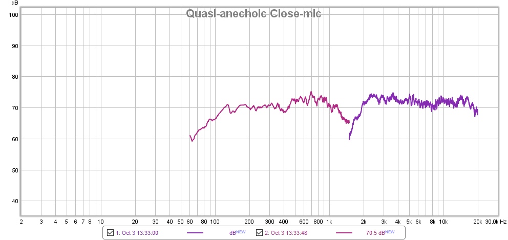

What speakers are you using? The dip centered at 1500Hz looks like a phase cancellation or a crossover that has the -3dB/-6dB points too far apart, assuming it wasn't caused by Audyssey (and I have yet to see it do that). Is it switchable? You shouldn't need to use anything that creates anything like this. Your response through that region should look like the surrounding areas. That removes a good chunk of a whole octave, near the most sensitive range of 'typical' human hearing.
The response above shouldn't sound 'veiled', if anything, it should lack a bit of warmth because there's less mid-bass than mid-range and treble.
I would try tweaking the speaker placement and look into using something to break up the nulls in the bass (assuming you can't just put bass traps in).
What are the dimensions of the horn mouth of those speakers?
You are in denial about the awful crossover problem with those speakers. I have always felt that the crossover is too low. The low frequency cut off of a horn is entirely determined by the dimensions of the mouth. Those Klipsch speakers have always looked to me to have too small a horn mouth for the required FR.
I suspect the woofers do not have the FR to be crossed over where the horn needs to be crossed over. There may also be severe phase issues with the crossover.
That dip makes them not a good reproducer at all. I would never leave a design like that.

As I’ve previously pointed out, that dip is introduced by the room, not the speaker. The right side of my wall has a large window that is mostly uncovered except for blinds and 36”x24” acoustic paneling at the first reflection point, the panel is placed to catch reflections at a distance of 11’, not 4’, and therefore, the window reflection at the measurement spot is responsible for that dip. The left speaker measured at 1m gives this response, which does not display a dip.

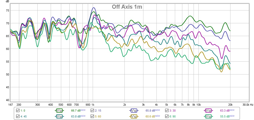

Ignoring room interaction, you can see that, like every other Klipsch design, directivity control for the small R-14m starts at around 1.5khz. One benefit of a smaller horn in this case (I think it’s somewhere around 3” square?) is that the directivity extends all the way out to 20khz, vs 14khz in the bigger horns.
For a $100 (on sale) a pr of speakers, the response is surprisingly flat.
Every two way Klipsch speaker from the reference II series on up that I’ve measure thus far displays very similar results, with very consistent control of directivity beginning somewhere around 1khz, regardless of xover point.
I am not simply repeating marketing BS, in fact, none of the consumer speakers say anything in their marketing info regarding most of this stuff outside of vaguely mentioning controlled directivity, it was determined by taking measurements, and then, out of curiosity, researching the design of the modified tractrix ubiquitous in both professional and consumer models. There are posts from Roy Delgado (along with a few other Klipsch employees), the original engineer behind the modified tractrix design, floating around that touch on the design being based on both constant directivity and constant coverage (ie the directivity doesn’t change with frequency) and the fact that nearly all Klipsch speakers, from the reference II series, icon k series, the modified “Best Buy” Reference series, old synergy series, Reference Premier series, palladium series, and most of the heritage III series horns are based on this same design.
