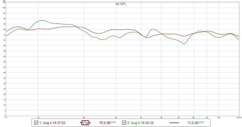

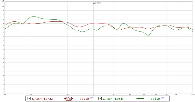

Below is my multichannel plot, green is Audyssey off.
Hmm... I can plainly see where and how it is correcting some of your peaks and valleys. I'm really starting to think that my problem with Audyssey isn't necessarily related to the EQ settings, but maybe a phasing issue with the sub and possible axial issues with that center channel. Like I said, regular 2.1 music sounds really good, but HT audio is a hit or miss situation, most of the time missing.
Not sure how I could better tweak the distance setting of the sub without a proper mic and REW program beyond what Audyssey has, so I think I'll get one and try it out. To me anyway, after reading all these responses and thinking on things it makes the most sense. If the sub is out of phase due to a wonky distance setting of course it'll muddy up at the MLP. If these were all brand new speakers and sub that I had no prior reference on, then I might point my finger at them, but I know what they can do, and I know what they can sound like.

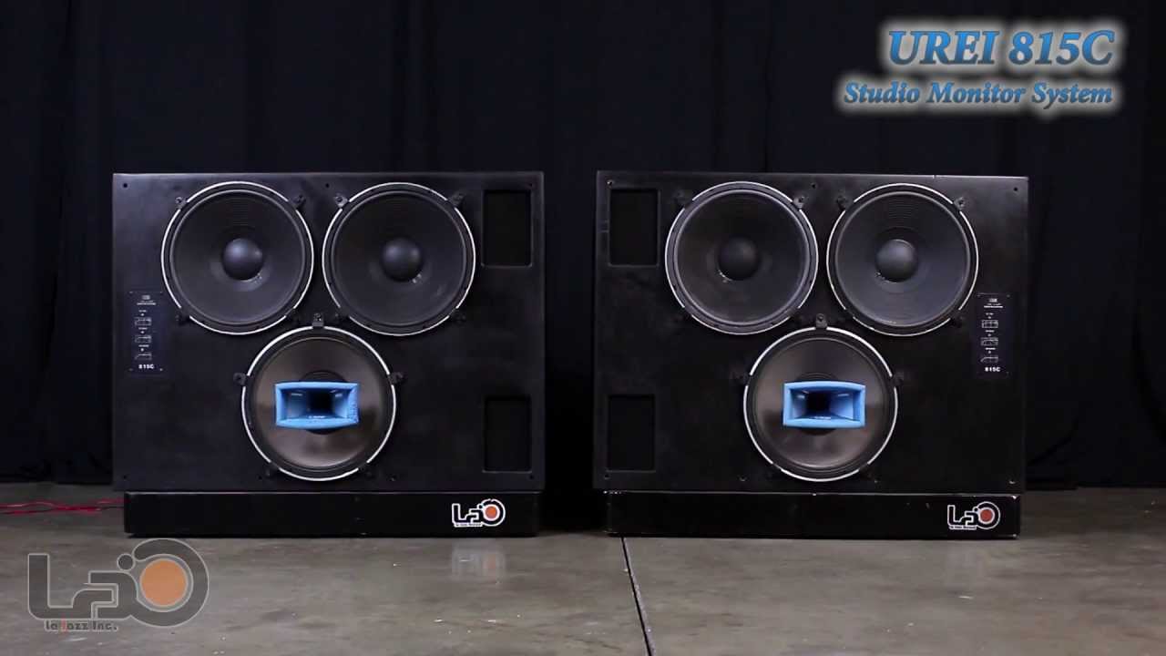

Now to Halon's rock issue and subs.
Unfortunately musicians and others want to come here to master their work. One is a well known guitarist, song writer/composer.
People in the studios no longer know their craft. I have been working with a guy in LA who apparently has Grammy's that has had enormous difficulty providing me with a mix down I will even master.
Now I have one I can work with, but there is far too much 1 to 2 KHz output and actually not enough bass. Well I visit modern studios and I note mixing being done at high level with diminutive mix top monitors and a huge sub. The sub is turned up far too high and that is what they mix to.
So the customer ends up turning up his sub too high.
This musician has brought me a reel to reel master from his work in the 80s that he wants me to master to CD. The monitors used were the old renowned studio Urei speakers.
This was the sort of gear prevailing back then.
So I loaded the 10.5 inch reel on my Revox A700 and guess what. The sound is perfect with plenty of bass. When the customers get it, they will be turning down their subs, guaranteed.
I'm not going to Eq that tape at all!
There in lies a lot of the problem.

My REW/UMIK-1 before and after plots (I posted them a few times on this forum) clearly show Audyssey XT32/subEQ and even XT are doing a good job. I ran all 8 positions as recommended by Audyssey but I know in the end the sweet spot is within inches from the main sitting position. If I sit anywhere else then all bets are off.
