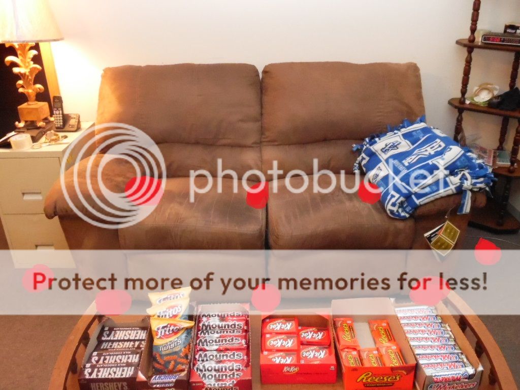

Folks, when running Audyssey the first (6) measurements are very easy to get/read. However, the last (2) are NOT because my seating position is against the wall as seen in the attached photos. The first (6) measurements are very easy to take at ear height, but the last (2) are not. Even with my tri-pod at its lowest level it is still above ear height. Any advice on how to deal with that problem? Want to take measurements that are as accurate as I can get. Just saying.........

fuzz092888
fuzz092888
Given that setup, I'd probably do it in the spots labeled below. All measurements need to be ear height.
Alex, I see that YOU spared the candy.....LOL!!!! looks like my UK blankey has been spared too.....LOL!!!! Too bad I am out of Snickers! :eek::eek::eek:
