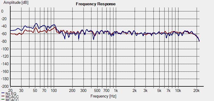

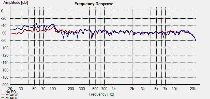

Ran a sweep below reference levels with eq off and MCACC on both with no sub eq on. Keep in mind my room is treated.
By the way, it is a plus that in that example you show, that the Pioneer system does practically nothing especially to the high end response.
If the room correction does NOTHING, then why bother using it in the first place? Why not just bypass it or don't use any EQ at all?

My experience with MCACC is the same as the poster here, it doesn't do much of anything for bass frequencies which is were EQ is needed most.
