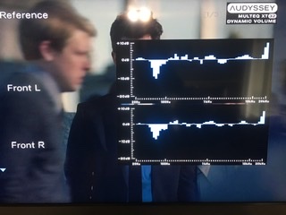

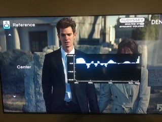

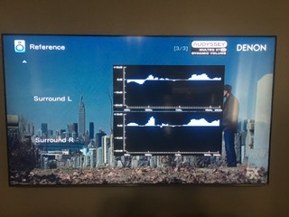

So... music and movies were sounding great. Like a true rookie Audioholic, I decide to recalibrate since I got the JBL speakers.
Auddessey calibrated the speakers as large and set the crossover at 40.
I set them to small and crossed at 60. The center and surrounds are set at 80.
The gain on the subs was turned down to about 11 o’clock to reach the 75db level. I bumped that up to 1 o’clock after calibration. The calibration level of the subs was -9.5. I did not adjust that.
Auddessey graphs of the calibration results are available. If I post them can someone explain how to interpret them and what improvements are indicated.

Thank. EA8F5BE4-0597-4CD1-89D7-E01DCFBF95FD.jpeg3BE0B440-924E-4BC2-A1CB-A9EB7E5B87B4.jpeg5EF929DD-9DD2-4E9E-AC3D-62D38B18B16E.jpeg
Audyssey doesn't set the speakers to large (i.e. to not use bass management), that's your Denon doing that (Audyssey's position is that when a sub is used bass management should be employed, and generally suggests a starting xover of 80hz ), the 40hz crossover suggestion indicates the lowest it will provide eq for (you can always raise the crossover, but Audyssey wouldn't suggest lowering as it would leave a gap in eq). I've crossed my 590s in the range of 100-120 but depends on whether you get sub localization or not (I don't). I prefer to set the gain on the sub higher in initial setup to get the avr to set the avr's sub trim lower....I usually aim for about -10dB, then just raise that up to taste. Once I run calibration I don't change the gain on the subs' amps.
