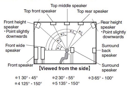

If I’m looking at the right image that you posted, that includes a pair of upfiring modules piece on top of the mains. I would absolutely recommend pushing forward to Atmos land, but you’ll need to buy a couple pairs(one at least) of speakers. Either AE(atmos enabled) or one or two pairs for the ceiling. Fwiw, if it’s not toooooo much for you, I would also recommend x.x.4 vs x.x.2
IME 5.x.4 is better than 7.x.2

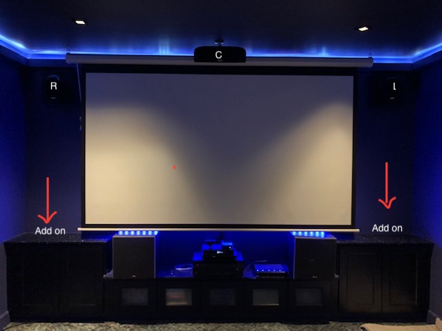

I've attached a screen shot of the front half of my media room. My LCR speaker placement is based on pre wiring that had been done in this room.
with 5.1.4 in mind wondering about placing atmos add on speakers L and R on the built in cabinetry. Would this be crazy considering my regular L&Rs would be above?
with 5.1.4 in mind wondering about placing atmos add on speakers L and R on the built in cabinetry. Would this be crazy considering my regular L&Rs would be above?View attachment 25863
Suppose you could move the center down and use with new L R speakers and use the high ones as front heights. Getting upfiering atmos speakers to work with LCR that high would be crazy yes.
Sorry but that would absolutely not work at all. What might work is putting the mains where you’ve indicated to put the add ons. You would then run the avr with “front height”(not the same as old skool pliiz)vs top height. You’d also need to lower the center channel. That should be simple.
this image shows the difference locations supported.
