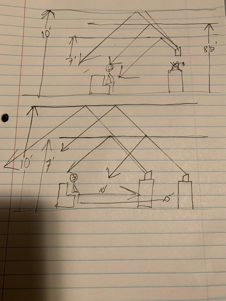

As long as the geometry is right in your room, then go for it. But this is the big problem... most people are throwing up firing atmos speakers into places where they aren’t able to function as intended.
Use the Dolby guide, check the math (and yes, I know most people run from geometry, but if you don’t want to waste money...), and then decide if it will work in your space.

I think the cost of admission is low enough to try. I think you could get similar performance from the elacs as Andrew Jones helped develop them, and he is a big advocate for bouncy speakers. I do NOT share his enthusiasm for them but the modules are cheap enough to try out imo. Just know that it will take a lot of fussing around to get right. Finding the right spot so they throw to your seat will take time, and if you have a highly textured ceiling, it will likely fail. You may also have to experiment with tipping them forward or backward a little. Ceiling height, and distance from will change where the sound path needs to go.
And keep this in mind, if you’re not happy with the results, it’s not necessarily a fault of Atmos. I’ve seen people try the modules and it doesn’t work and then they go and carry on about how dumb Atmos is etc.
Also, with hundreds of Atmos titles available, and the excellent upmixing capabilities of DSU and DTS-X, I can’t see why not to. Although I would personally recommend at least Height speakers vs modules.

Bill’s thoughtful drawing illustrates well the point I was trying to make. :)
