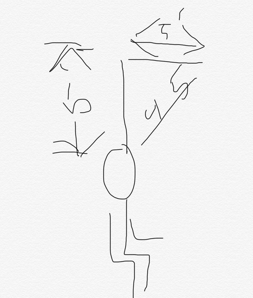

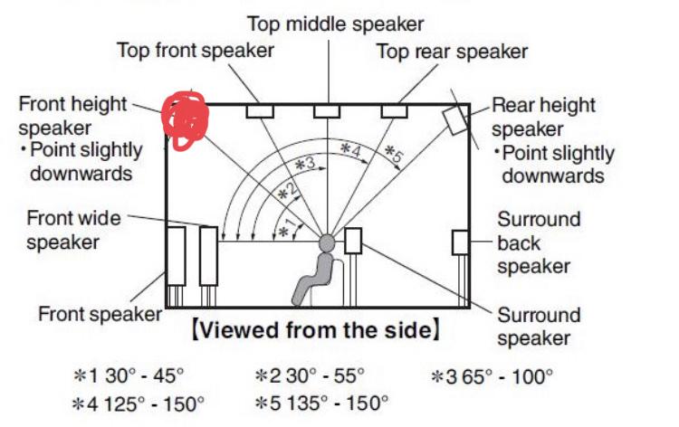

Actually no, in a .4 the tops should be at 45° fore and aft of the LP. So if the distance from ear to ceiling is 5’, then measure straight up and the fronts should be 5’ in front, and 5’ to the rear. Obviously that’s an ideal situation, but it is the spec so... I would look at a really good .2 in your case.
(Disregard d the doodle lol)
Here’s some reading. I’ve had a hard time finding the original docs, but here’s one. Good reading.
