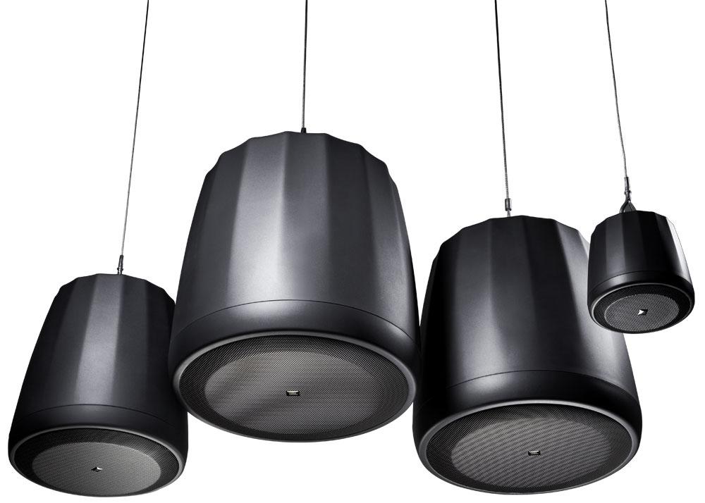

With that kind of ceiling I’ve always thought something like these would be a good option.
I think one problem with your space is the ceiling looks to be too high to install speakers that would meet the correct elevation angles, and more so the azimuth angles. You absolutely could install speakers and just get what you can get. But I think the pendant speakers hanging at the right heights are worth considering.

I haven't heard that particular Paradigm but I have an older pair of in-walls similar to the E80-IW and I've been very pleased with the sound. You want to timber match the fronts and preferably surrounds as well but I don't think it's as critical for ATMOS speakers since you're dealing mostly with effects.
My biggest concern would be the height difference. Your AVR might be able to adjust for the timing difference, but not the difference in dispersion over distance, as well as the angle relative to the listener. The L + R ATMOS channels may not sound the same and would likely not be within the recommended ATMOS spec.
Other issue is removing insulation to install cabinets for the in-walls. If the cabinet is larger, then you have to remove the drywall, install the cabinet, reinstall / repair the drywall and repaint. If you live in a cold climate where it gets below freezing, the lack of insulation may cause condensation issues. I would not be too concerned about the wiring as any competent installer should be able to get wires into that space, although some drywall repair may still be in order. I would lean towards the pendant idea from William.
