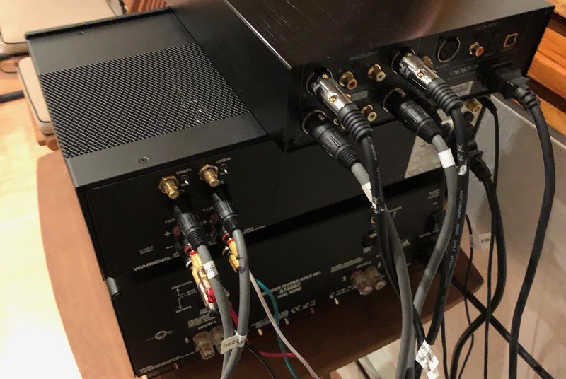

From the article:
FLAC files were played via Roon playing to the Oppo UDP-205 connected via balanced inputs to the Oppo HA-1. The HA-1 provides fully balanced preamplification.
Level matching was done using voltage measurements while connected to the speakers playing 250Hz and 1kz tones. It was then verified using pink noise, REW and the UMIK-1 microphone.

Thanks.How did your switch the 205 between the two amps?
How close was that voltage for level matching? How was it dialed in to such close tolerance?
RichB
RichB
I used the HA-1 for volume control which has .5 dB steps.
They were within the 1 digit of precision (2.8x on both). Basically, I got lucky and they matched well within the .5 dB adjustment range.
This can be seen in the near field measurements.
Originally, I split the XLR outs of the HA-1 to both amps and switched on speaker leads and adjusted the volume levels.
However, the AT4002 showed some roll-off after 10kHz. @PENG suggested this could be a difference in input impedance and changed to also move the XLR's which seemed to fix that problem. All measurements used are taken durin the same session to assure that there were no changes in the mic position.
Both amps were placed on an table to make switching easy. A towel was placed over the HA-1 to hide the volume levels and the amp connections could not be seen from the listening position.
