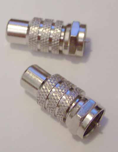

I posted this in the other thread too:
Banphan gave you the answer in post #4
It may look like a video out cable, but if you plug it into the video (yellow) port of a TV or VCR it won't work. The Atari output cable is an RF cable designed to play on US TV channel 3 or 4. There are several options available at Radio Shack to hook it up properly. Female Phono Jack to Male F-Connector will plug onto the end of your video game's RF cord and allow it to connect directly to the back of a TV via the 75ohm cable connector

no its not an F-connector, this is really old school stuff though its just one single RCA cord that runs out of the Atari and there is sound on the television when I'M playing it and video so i assumed that both audio and video travel through it

yea i know the part about changing it to a f-connector already Rickster71, i just want to convert it to an RCA so i can plug it up into my reciever
does anyone have any ideas?
You don't understand.
A receiver won't take an RF signal and do what you want with it.
You are confusing the type of connection with the type of signal it's carrying.
Does your TV have a red and white RCA audio-out. If so, hook that to the receiver.

One last shot at this.
Send the RF through the input on a VCR and let that convert the whole thing to composite, that can be sent into the TV and a receiver.

As said in the other thread (WHY TWO THREADS?)... This is the adapter to take the RCA connection to an industry standard F-type connector to connect to the back of your VCR...
The Atari used to come with a box which did this and allowed for cable/Atari connections.

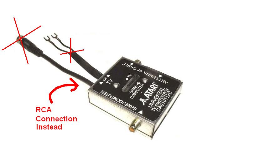

hey i can do that allready Rickster71 i want to be more organized and connect it to RCA inputs on a switch box rather than to a the an f male on a television
note: the switchbox goes to the reciever then to the television

this is what i mean...
maybe this will clear things up
oh yea i already have that device
this is basicly what i need to have happen instead of the one F Connector on there that says (out to TV) i want it to be RCA out

ok I discovered a sollution
this is what im gonna do
im gonna use these two
will this work?? i want the RCA hook ups on the (RCA CRF907) RF Modulator
to be output instead of input so i can connect RCA wires from the RF Modulator to the television or receiver
